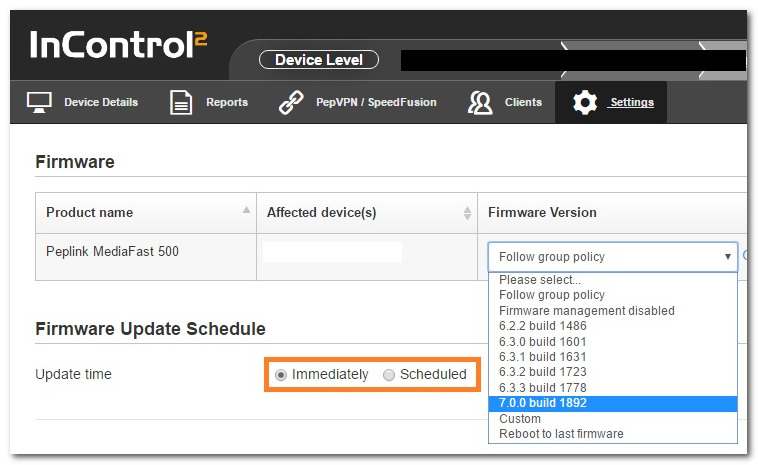

- Access the Slave router “Firmware Management” area from the device level within IC2.
Step 2: Configure the upgrade parameters.
Select “Immediately” to begin the upgrade now or “Scheduled” to perform the upgrade at a later time.
Select the firmware version from the drop down list.

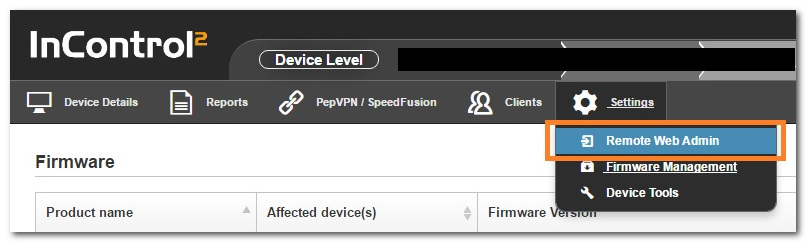

Step 3: We recommend verifying the configuration after device reboot.
- Select the “Remote Web-Admin” to verify the configuration following the upgrade and device reboot.
