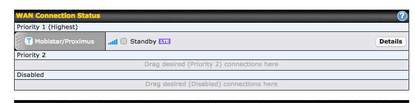

I connected to the BR1 using a port forward from the fusionhub and I disabled the “send all to SF”, BR1 didn’t come back online.
When I want to ping an address,
Cellular1 is not in the list of choices as it is in standby.
The fusionhb is sending all traffic to the LAN
So only direct mobile internet breakout can be used to access incontrol. But apparently the BR1 only uses it to establish the SFusion.
