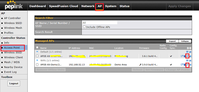

Are you referring to the AP Controller firmware pack ? If yes, that will be depreciate soon.
For the firmware management using the AP Controller, we can now set/trigger the upgrade/downgrade the AP firmware easily instead of relying the old firmware pack method.
For more information , please refer to the attached screenshots.

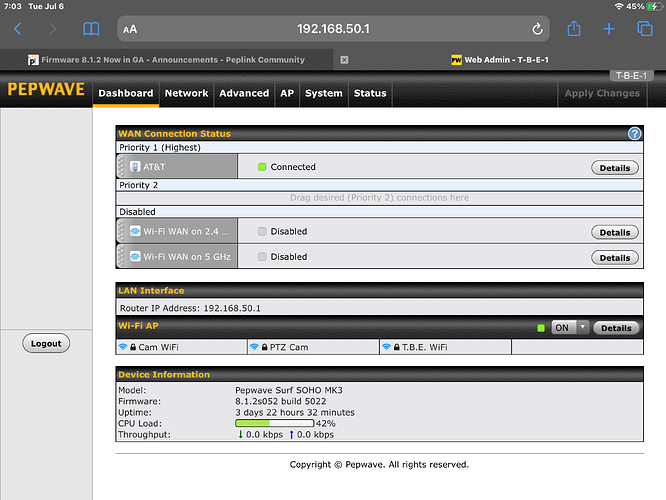

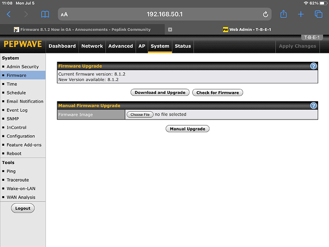

Hello and Good Day
Our Surf soho is showing new firmware the same as what’s already in use. Please see screenshot.
Why is this?
If you’re trying to verify that the new firmware is being used, check the dashboard. The latest firmware shows up there but it doesn’t in the Firmware tab under System.
“8.1.2s052 build 5022” is the latest firmware, so you’re good.
Thank You again for the help.
But I don’t understand why it shows a update to download.
I’m with you on that one.
@Ballistic, @rmrcu10, this is a special case where the GA firmware has been replaced with the 8.1.2s052 special build. The team will look into getting this fixed soon, to avoid confusion. Stay tuned. ![]()
Update [09 July 2021]
The firmware server has been fixed, and I have tested on our unit too. You can check it out and let us know the outcome.
Hi WeiMing,
Thanks for the fix. I’m running the new beta (so far, so good), and the firmware check shows that; perhaps Ballistic can let us know if he sees the results of your improvement.
