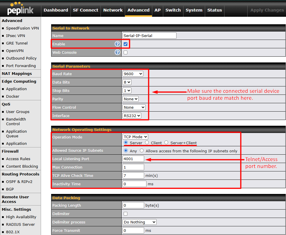

Please find below the picture and screenshot, specifically for MAX Transit, connected to Cisco router Console Port. It should be the same on other devices with Serial/Console port.
  1. Console Cable Pin Layout
  2. Cross-check the RJ45-to-MAX Serial Connection Mapping
  3. Connect to MAX Transit - Terminal Block Serial Pin
  4. Connect to Cisco Console Port
  5. Enable MAX Transit - UART Settings
    5.1 [Firmware 8.5.4 - UI update] MAX Transit Duo Pro - Advanced > Serial Settings
  6. Configure the Telnet/Terminal Emulation Client
  7. Access to Cisco CLI from the Telnet/Terminal Emulation Client (Preferably Non-Windows OS)
Note:
This configuration can be applied to other devices/instrument with serial (RS-232) interface/port, if you know the Pin-Layout and the Serial Parameters (Baud Rate, Data Bits, Stop Bits, Parity, Flow Control).
