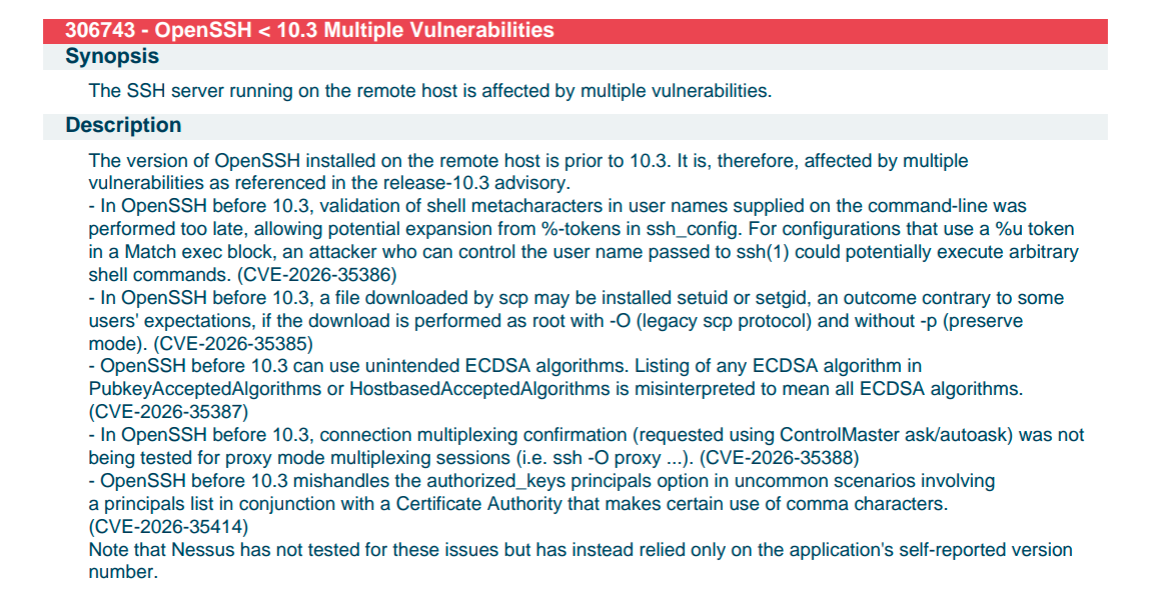

We are using Balance 2500 (Firmware 8.5.0).Nessus flags OpenSSH as High Risk.What is the solution?

After firmware upgrade, Issue still remains.
