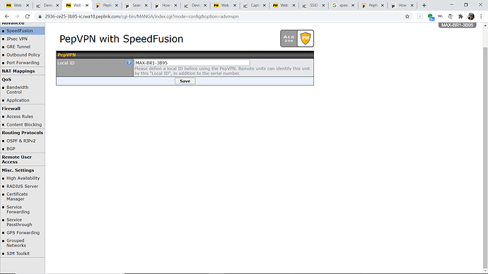

Can someone point me in the direction of instructions on how to configure the MAX BR-1MK2 as an NTP time server?
I need mobile devices connected to the AP to be able to sync time to the MAX BR1MK2.
