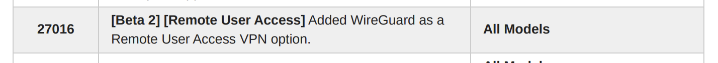

Is Wireguard Remote User Access supported on FusionHub? Any limitations?
