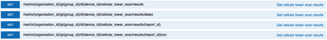

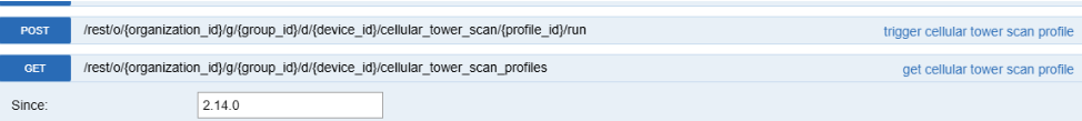

Hi Chris,
#2 the API are already available for Site Survey. They where recently introduced :wink:
Can you let me know where the updates api is that shows this call?
I checked here and it’s not listed.
Hi Jonathan,
please check this:
This should answer your question :wink:
