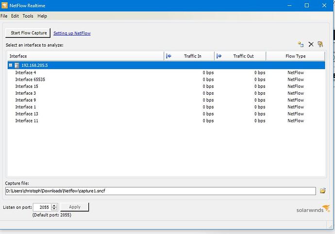

After proceeding according your advice and reading the Netflow-Tool’S help file, it remains unclear to me how to create the right interface. See screenshot.
How do I need to set the Credentials → public or private? Tried both, but did not work for me…
Or shall I better use SMTPv3 instead? As this leads to some more options, I am unclear how to fill them (like Credential set, context, auth and encrypt settings).

You’ll need to set up a SNMP community on the Balance first. Got to System > SNMP create a community give it a name set allowed source network then save and apply.
eg
Then use those settings in solarwinds.

This is what I changed based on your screenshots and could try out successfully as configuration:
I hope this is, what you advised??
Which of the streams are you usually using?

Am I the only one that has only one interface supporting netflow?
It loads with Flow Type to Netflow for all then:
Only LAN runs netflow.
On my balance one I saw both active WANs and the LAN with netflow
Maybe demo version of Solarwind is doing this, I’m testing with another tool.

For the Netflow feature that just introduce in firmware 8.1.0, it doesn’t include the Netflow MIB features. In other words, configuring the Netflow or collecting the flow data using SNMP is not available yet. I have discussed with Engineering team and the Netflow MIB features will be consider for future firmware.
As for firmware 8.1.0, by enabling the Netflow configuration at the Support.cgi page, the device will only export the IP Flows information to the Netflow collector.
You need to make sure Netflow collector service is enable for your Netflow server in-order the Netflow server can received/analyze the IP flows information that sent from Peplink devices.
