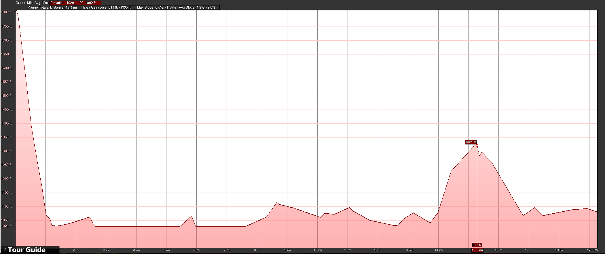

Thanks! The previous year I used one of these antennas with a Wilson Quint 70db cell amp/repeater then another “inside” panel antenna 50’ up the hill towards the camp site. It worked pretty well for voice and data, but no where near as dependable or fast as just the BR1 with the dual antennas, even with less overall gain. One key thing was locating the exact cell site we were connecting to then using Google Earth to plot the distance, direction and terrain. If you use the ruler tool then name and save the route, you can right click to show elevation. Sliding along the plot with your mouse gives exact elevation and it is easy to see the ridge on the attached route. The cell tower location (on a mountain) is on the left and the camp site on the right. Factor in the height of the tower and you can see how we were able to get past the ridge. With straight line of sight and no obstructions I’m sure we could have gone a lot further:
