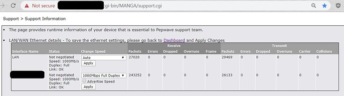

The Surf SOHO has a somewhat hidden support page that should be your next step. This image shows the URL and what the Ethernet details report looks like when all is well. This should show any type of interference, no matter what the source. On the downside, I just noticed it only does LAN and WAN, so it seems to lump Ethernet LAN with WiFi LAN. So watch it while there is no Ethernet traffic on LAN. Screen shot is from 7.1.2, maybe different on 8.0.2.
Another advanced option, one that’s really cool, is that the router can do an Ethernet packet capture, all by itself. This too is on the support page. If the Ethernet report shows trouble, the packet capture should show exactly where the trouble is.
