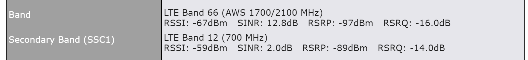

One follow up question. When you say the router will aggregate bands what does that mean? For example, if I select band 2 only on modem 1 for card 1, is that going to cause aggregation to occur?
Your Max Transit Duo has 2 cat 12 modems, one for each sim. It is a 2x2 MIMO router (these have two cables that can be connected to 2 antenna ports per sim). With MIMO, the router can “connect” to two channels simultaneously. This will ALWAYS give you better performance than just one channel. You can’t tell the router to aggregate - it just will if you have a MIMO antenna attached. It will aggregate the same band twice, or different bands. There is no control over this as it’s based on particular tower characteristics and very complicated internal stuff.
If you have a MIMO antenna connected, you can click on the LTE connection on the Peplink Dashboard and see that it has connected multiple times.
