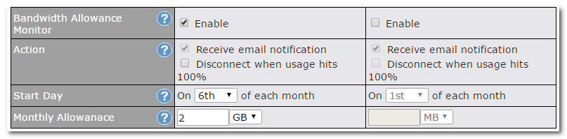

Controlling cellular data usage
You can use the built-in bandwidth allowance monitor to control the amount of cellular data used to help prevent data overage charges.
To do so, under Cellular Settings, look for Bandwidth Allowance Monitor and then tick the Enable check box for the chosen SIM card.
Note that data reported may differ from your network provider’s meter.
Once enabled, further options open up. The first things to set is the billing cycle date. Set the start day of each month so that the allowance counter resets and then enter cellular data you’re allowed in Monthly Allowance.
Next, you can choose what actions the router would take once the cellular data limit is reached, such as the ability to receive email notifications (if already set up previously), or to have the router stop using the selected SIM card altogether by ticking “Disconnect when usage hits 100%”.
The same can be configured for SIM B.
