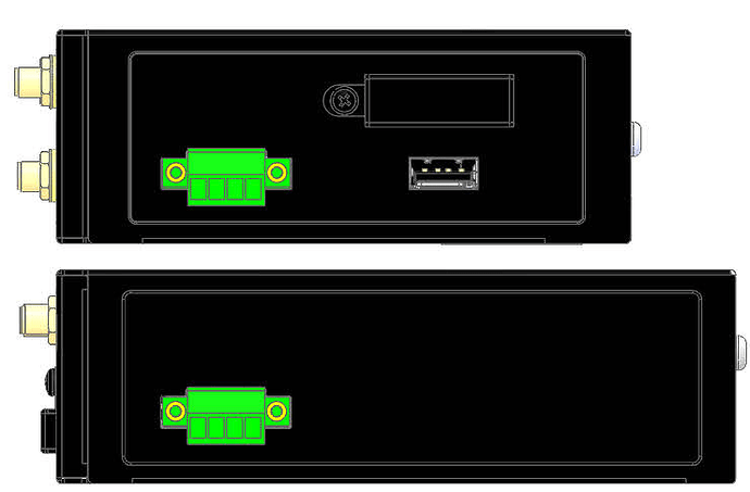

Ok - here is the latest info:
The current UBR Plus is unchanged, I just want to clarify the following items are all regarding the upcoming HW revision of the original UBR, which we are tentatively looking at mid 2023 availability.
We have two basic options:
  1. Copy the old form factor and layout.
  • This version will also have USB, but it will have to be located on the top
  • This new HW version doesn’t fit on a single board inside this enclosure, so it will be significantly more expensive than option 2
  1. Make a larger but extremely similar version that is able to put the USB port AND the SIM cards on the front, so only the power terminal is on the top. This version will also be DIN mountable.
What would I do with the USB port? Well, you can of course add a MAX adapter or a USB>Ethernet for additional WANs, but I think most interesting for this model is the new USB>Serial adapter support in InTouch in 8.3.0 (beta). This will let you add something like this to give you access to 8 serial ports.
Here are some mock ups to review. Please share your thoughts!

Option 2 :<)
@Travis I know we’ll never use the USB port. But that’s us. To me it seems overkill to add to the UBR.
So let me ask you. Are you adding this feature because of the amount of people that have asked it to be added? Or are you adding it to just add it?
I’m not fond of the taller UBR you mocked up. Mainly because available DIN space between DUCT. I’ll refer to my photo in the OP. That DUCT space above/below the UBR is a very common height. You don’t want the UBR to be so tall that it makes panel builders abuse panel space. The UBR-LTE that you currently offer is an average height compared to other industrial devices. I can send you of photos for comparison if your like.

Opt2 for me too.
We want this UBR to be aggressively priced and the USB connector for RS232 InSight Serial console / device management is a really powerful / valuable capability.
First, thank you for sharing this with us!
And definitely Option 2.
