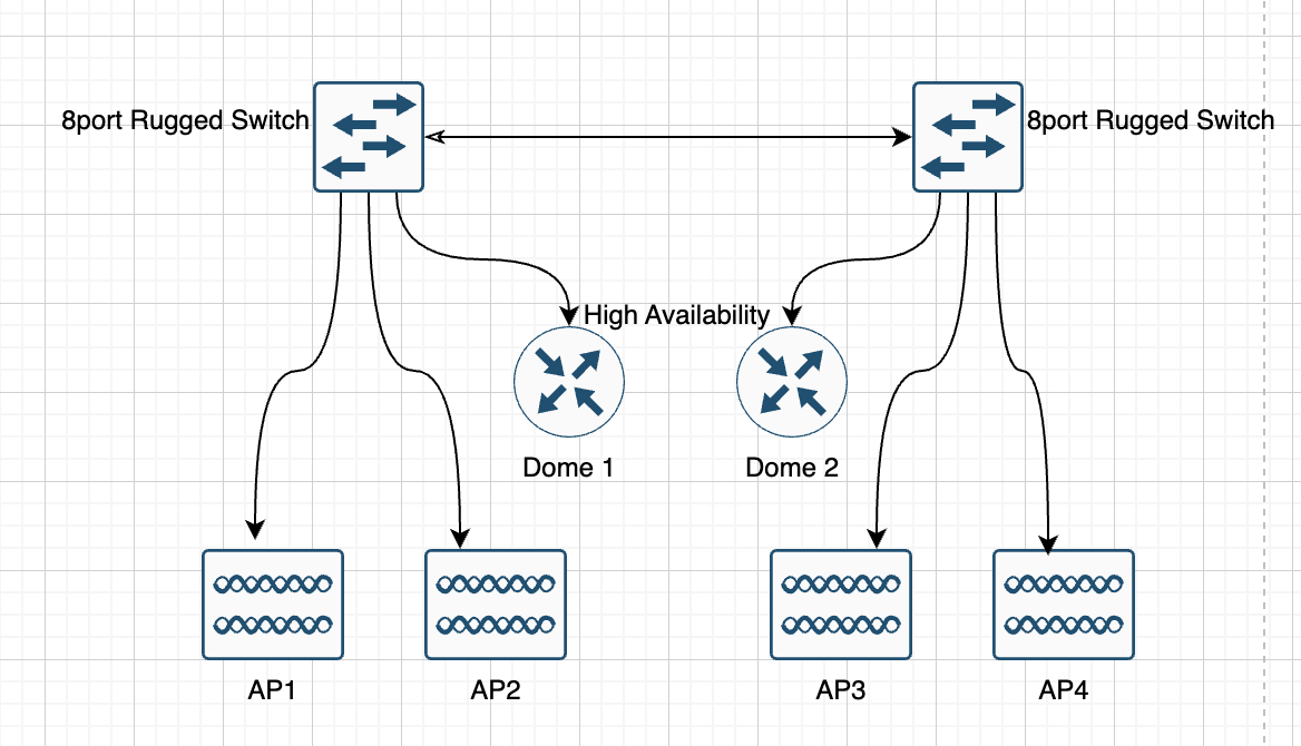

The initial thought was to add a second switch and add the domes in HA mode. Something like this diagram
Your suggestion about adding a B-ONE router to balance the domes is super interesting. It is the perfect way to make good use of the second dome.
I’ve got a quick follow-up question about the B-ONE and High Availability (HA).
To get a complete HA setup and knock out all single points of failure, would I need to buy two B-ONE routers?
I expect synergy mode would work for this scenario. One Dome would be the controller, the other being synergized. The “failover” would only be for the case where the synergized dome fails, or if one of the cellular or other WANs disconnect…
