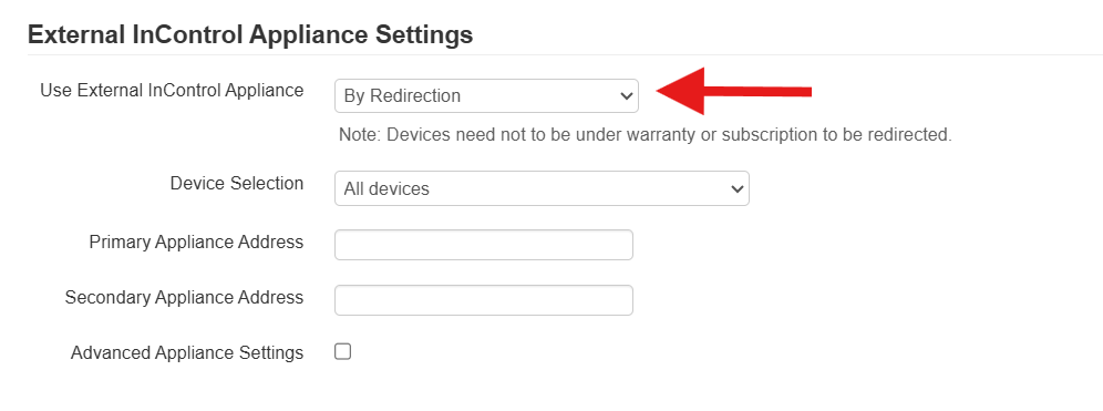

The switch ports are default in untagged VLAN. Normally for the setup, we will configure the Uplink device port using untagged VLAN and this will allow the switch to connect to the network before you manage the switch using the AP Controller or IC2 management. Possible that you change the Uplink device port setting using untagged to allow the connection ?
Current Switch firmware is 2.0.2 and it’s supported the “By Redirection” method.
For “By Configuration”, it’s in the roadmap now. I will update again when targeted firmware is confirmed.
For Local Switch configuration, as for now, it’s targeted for Switch firmware 3.0.0 :blush:

The private IC2 instance used has no internet access, so the public IC2 cannot reach it. Thus the by redirection method will not work. According to the data sheet, the enterprise switches should work with private IC2—right now, that’s not the case.

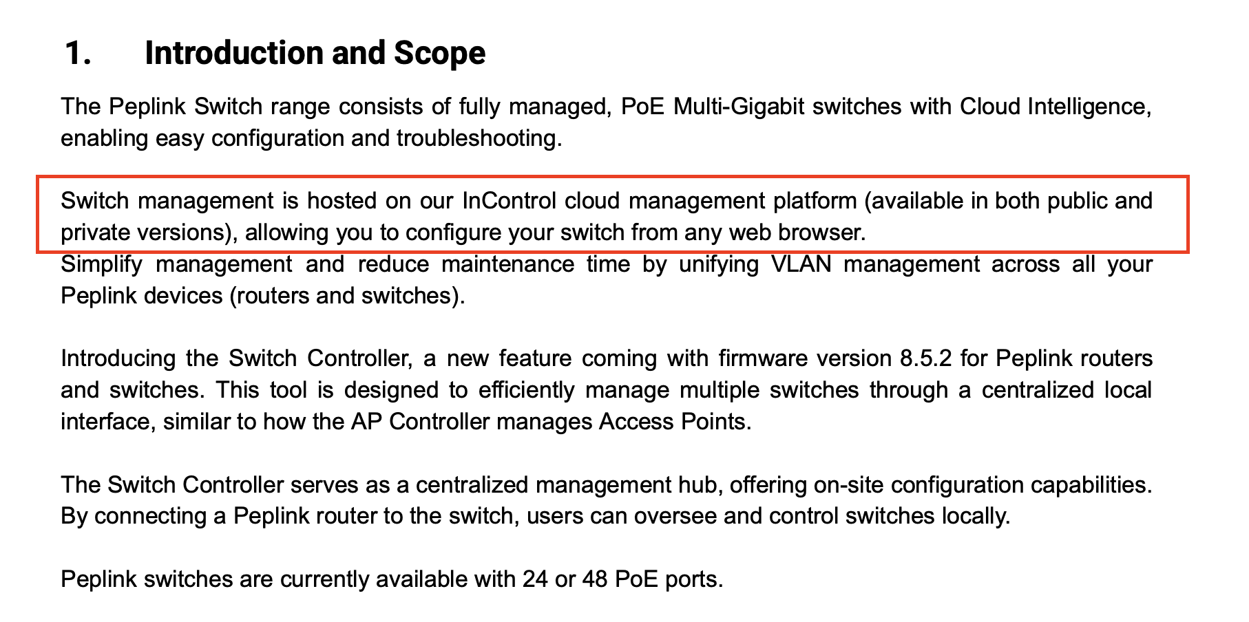

Portion of the manual that states that a private IC2 instance should be able to manage the switches is attached:

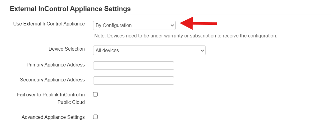

I’m discussing with the Engineering team, if the switch able to support the IC2 “By Configuration” to configure the ICVA settings for the Switch, will this temporary help for the issue ?
Meaning to say you need to bring the switch online in IC2 to configure the ICVA setting using “By Configuration” after that the switch will connect to ICVA.

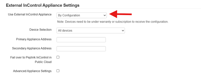

Do you mean using IC2 “By Configuration” to configure the ICVA settings for the Switch" having issue ?

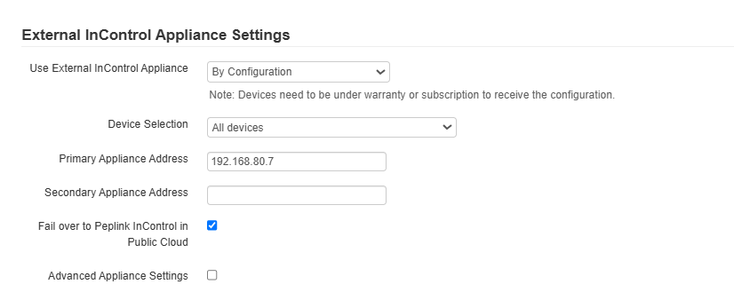

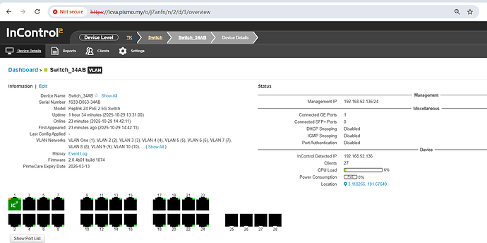

The issue is fixed in 2.0.4b1 build 1074:
I just tested and working fine for my device.
Yes, so the thing is, I can get my switch to register in ICVA by following the steps you described. However, this only works as long as I don’t power off the switch.
As soon as the switch loses power, the configuration is lost and it no longer reconnects to ICVA.
Here’s my setup: I have an ICVA in a network without internet access. To register the switch, I first connect it to the internet. Then, without turning off the power, I swap the network cable from the internet connection to the private network. In this state, it works fine. But if I power off the switch afterwards, it fails to reconnect to the ICVA when it starts up again. Ironically the “IC” lamp on the switch turns on but no connection to ICVA is happening.
Please make it so that the “configuration” actually stays when a device loses power? Or just add the same menu option that the old switches / every router have to select an ICVA instance…

By configuration will permanent set the ICVA IP for the switch. Can you create a ticket for the reboot issue ? We can definitely review the issue. I may miss the message previously.
