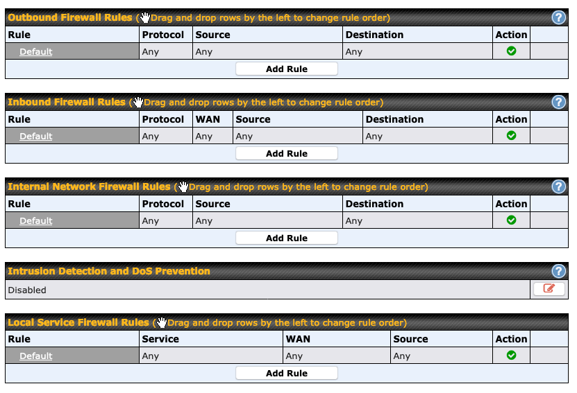

Hi, I’m unable to connect to several databases I use at work and am unable to determine the issue.
MySQL: port 3306
Flask Webserver: port 5000
MongoDB: port 27017
All of these work fine when I’m tethered to my phone or on a local wifi. I attached a screenshot of the firewall settings from WebAdmin, everything is wide open (unless there’s another place to check).

I looked at this some more and found out that it’s not an issue with ports at all, it’s that my public IP is either coming back incorrect or is changing.
I’m able to access the port on another server just fine.
It turns out that when I thought I had opened up my EC2 instance to the world I didn’t (I had too many security groups active). When I do open the machine up to 0.0.0.0/0, I’m able to connect. If I open it up to only the public IP I get from any sites that tell you your public IP, I get a network socket timeout. Somehow these sites that are telling me my public IP are incorrect.
Is this an issue with the Peplink Transit Max or an ATT (carrier) issue or maybe combination thereof? Any ideas would be very helpful.
