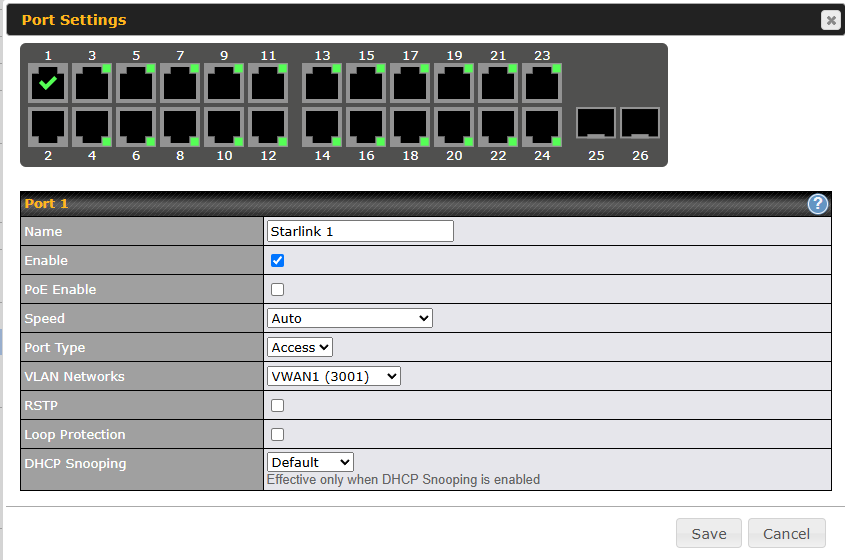

Peplink SD Switch 24-Port Rugged
1.3.2 build 569
Is DHCP snooping configured? That would cause problems.

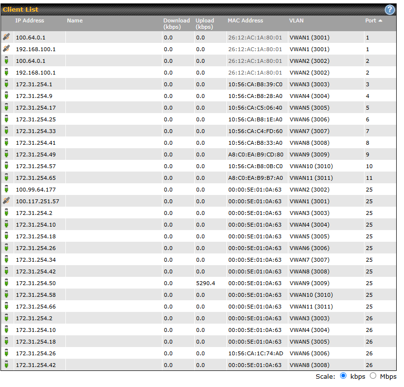

but I think this is mac related, in that starlink uses the same mac for the default router. Can the switch handle the same MAC address in multiple VLANs?
100.64.0.1 is 26:12:ac:1a:80:01 on every system.
What does the client list look like? does it properly have each entry of 26:12:ac:1a:80:01 for all of the Vlans?
DHCP Snooping is off. I have a bunch of HD Domes on this switch as well.
Then we are back to packet captures… Do you want to send me a copy in DM?
We should look at the trunk and the access port to starlink.
