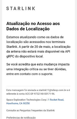

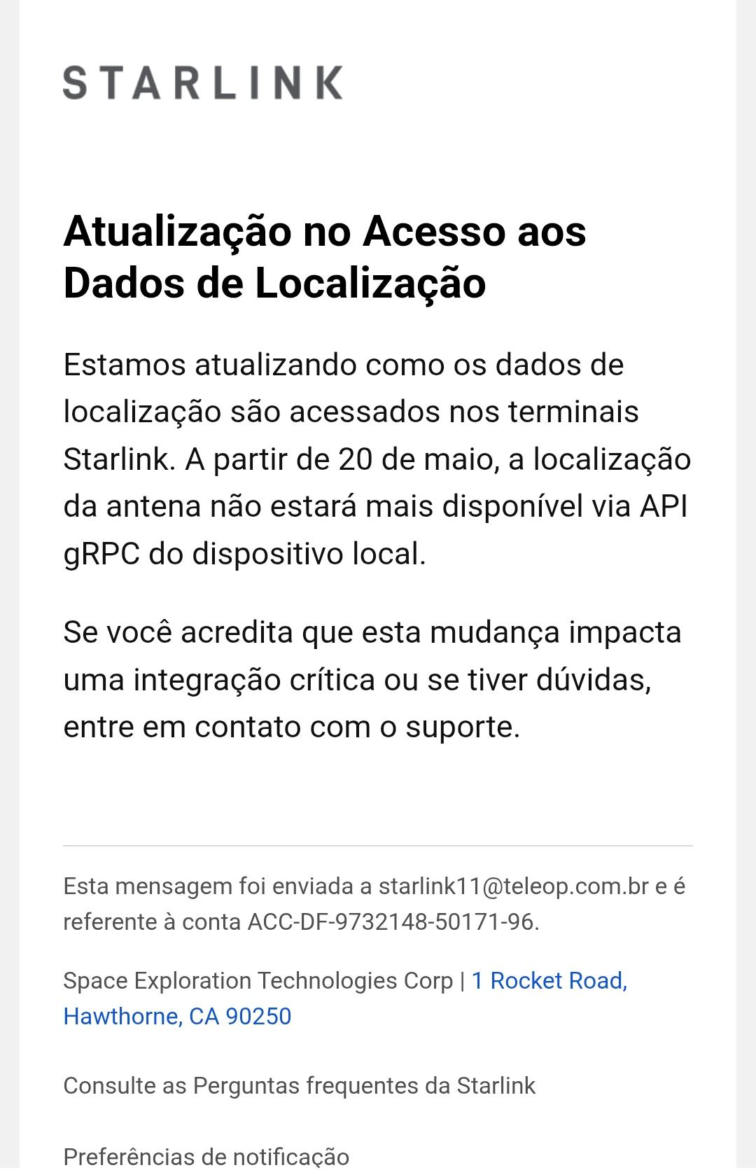

Just got an email from Starlink saying “We are updating how location data is accessed on Starlink terminals. Effective May 20, dish location will no longer be available via the local device gRPC API.”
Will this affect Pepwave getting GPS location data from a Starlink?

Same in Brazil.
That’s just it. Starlink says they’re “updating how location data is accessed”, and that it “will no longer be available via the local device gRPC API.”
They didn’t say they’re removing access, and the way they phrased it leaves room that they might be “updating” with a different method of getting it. Figured since Peplink is a “Starlink Authorized Technology Provider”, someone here may know more about it.
