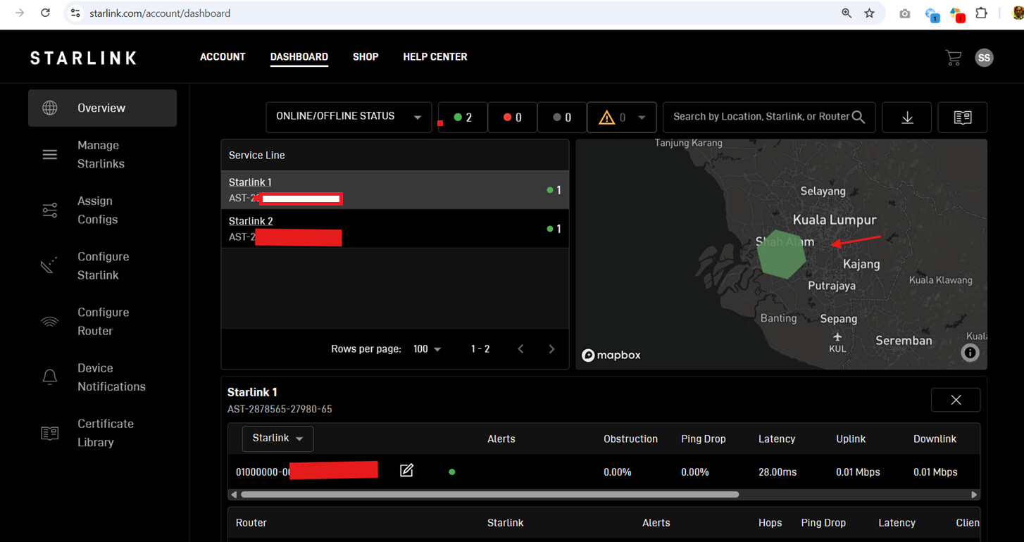

I think it’s still useful, but it should be display as h3cellid, shown on the map with a h3 hex drawn around it, and an optional google maps link to the coordinates. (H3 cellid approximant , lat/lon) as an example.
Further is the h3cellid available via GRPC or only via v2 starlink api?
It’s important that it’s not relied on and look at like accurate gps.

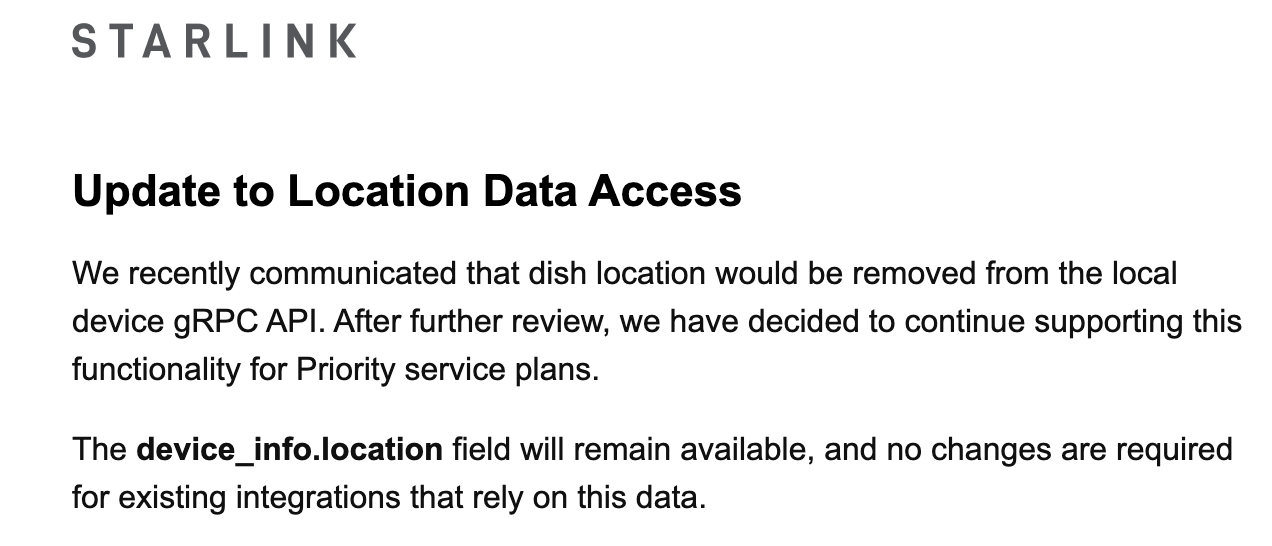

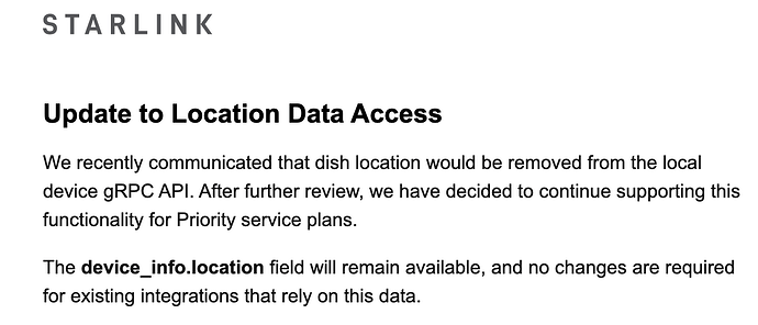

Looks like enough feedback was raised to the Starlink team, and they have decided to continue supporting location data access for Priority service plans.
Could you please check and confirm whether you have also received a similar notification from Starlink?
I haven’t received this yet, what was the subject?
Confirmed I received the e-mail and I’ll do some testing later today.
Subject: “Update to Starlink Location Data Access”
Confirmed Starlink GPS is working on a business priority plan.

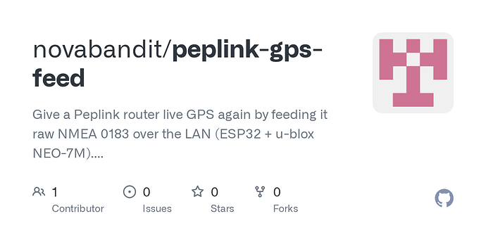

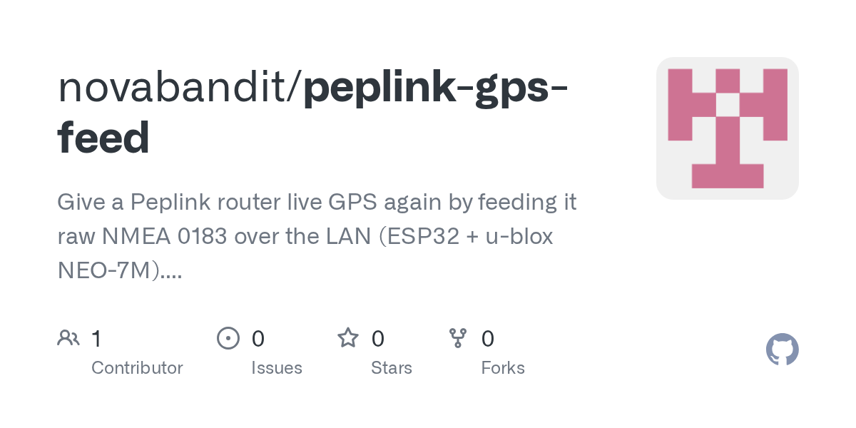

After Starlink disabled the GPS network feed that the B One 5G in my motorhome used, I worked with Claude code to build a fairly low priced GPS module to provide a network GPS data source. I already had a mobility 42g antenna on the roof for the external GPS antenna.
My use case is NOT business critical, so I didn’t want to go with the more expensive service plan.
It works great in my situation, so I put it on Github in case it helps anyone else.
