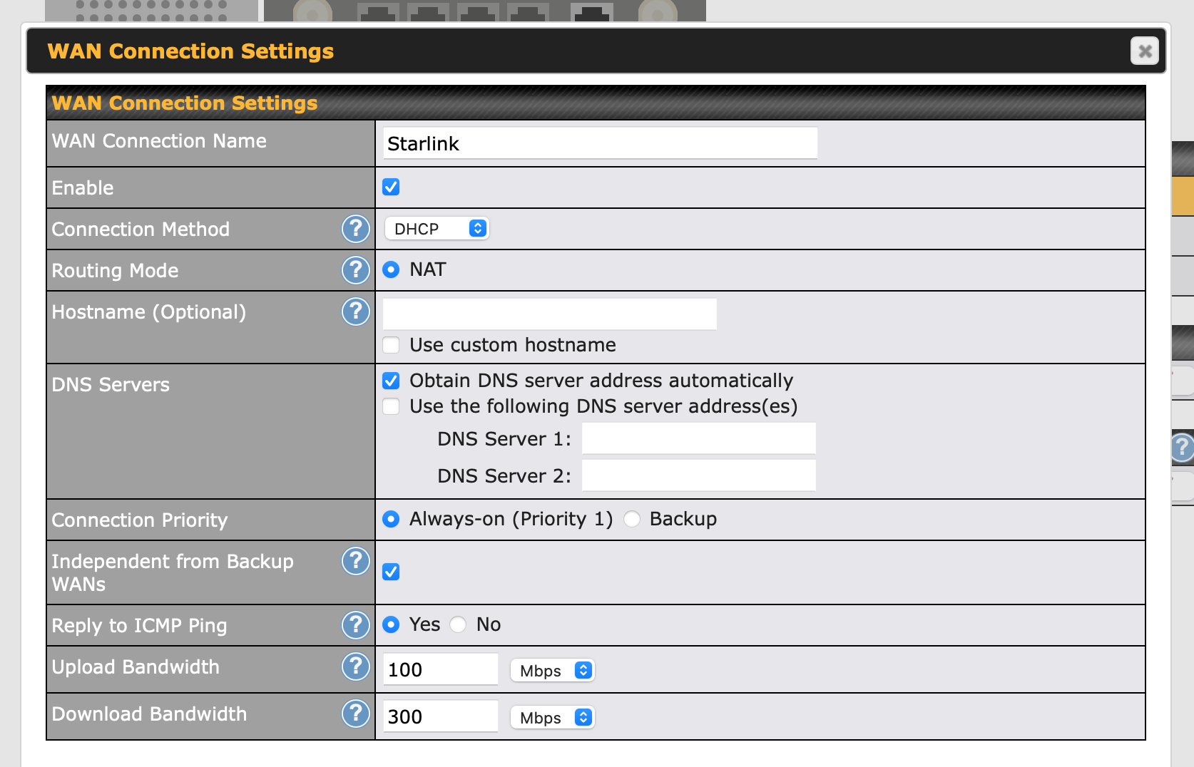

Reviving this older thread as I just received my Starlink terminal.
I am running the OOB management via a Juniper SRX connected via an Access VLAN, similar to my previous tests with the DSL modem. This works fine, and I may continue with this configuration to test and provide IPv6 via the SRX.
I also wanted to test a second WAN interface for the OOB managment, but my generic 1G switch was dead.
