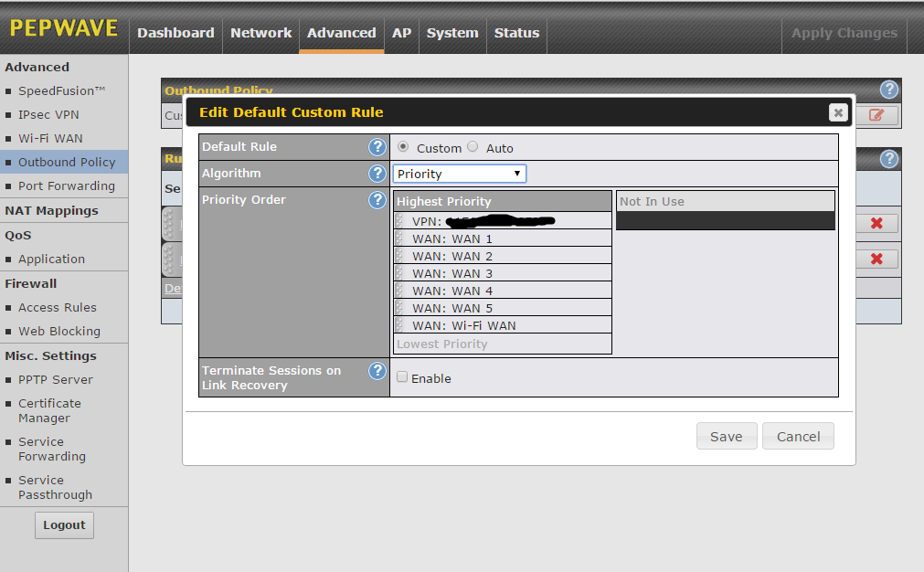

Did you enable your outbound policy settings using the PepVPN as the first priority?

Change your outbound policy to force your traffic through the speed fusion vpn

Have you made any progress with this? I recently got a MAX OTG U4 and have not been able to achieve any increase in bandwidth from bonding. I am running the latest firmware and have “All Traffic Send To” set to go through the SpeedFusion vpn. I believe this is equivalent to what TDComm refers to as “force your traffic through the speed fusion vpn”

As I understand it, your outbound policy needs to looks this this in order for SpeedFusion to bond your traffic.
Here are the algorithms you can currently use for directing your WAN Traffic:
Weighted Balance - Traffic will be proportionally distributed among available WAN connections according to the specified load distribution weight.
Persistence - Traffic coming from the same machine will be persistently routed through the same WAN connection.
Enforced - Traffic will be routed through the specified WAN connection regardless of the connection’s health status.
Priority - Traffic will be routed through the healthy WAN connection that has the highest priority.
Overflow - Traffic will be routed through the healthy WAN connection that has the highest priority and is not in full load. When this connection gets saturated, new sessions will be routed to the next healthy WAN connection that is not in full load.What I would love to see if a fail over algorithm that picks the modem with the best throughput/latency.

My outbound policy looks exactly like that but I still have the speed degradation issues.

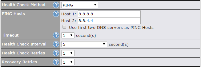

So, how can we convince the Pelink that the modem needs to turn off when the throughput/signal is weak?
Could you change the settings on the health check method to accomplish this?
Would that make your modems sensitive enough to a lack of throughput/signal for it to fail its health check?
