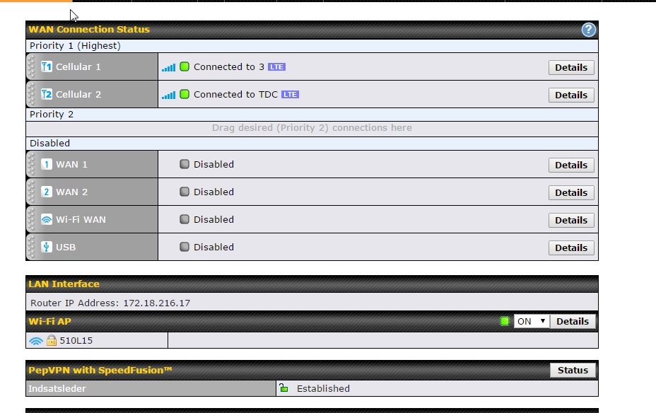

I cant seem to get the bonding to work either. This a stationary vheichle with a HD4 connecting to a 1350 Balance in our data centre. I get almost no performance gains at all using 2 sims cards versus 1. Even though they both have great coverage and get great speeds individually.
Outbund rules are set to Priority on the VPN on both ends.
Funny thing is we were thinking of building our whole ambulance fleet with HD2 & HD4 units thats upwards of 100, probably not going to happen with this hardware.

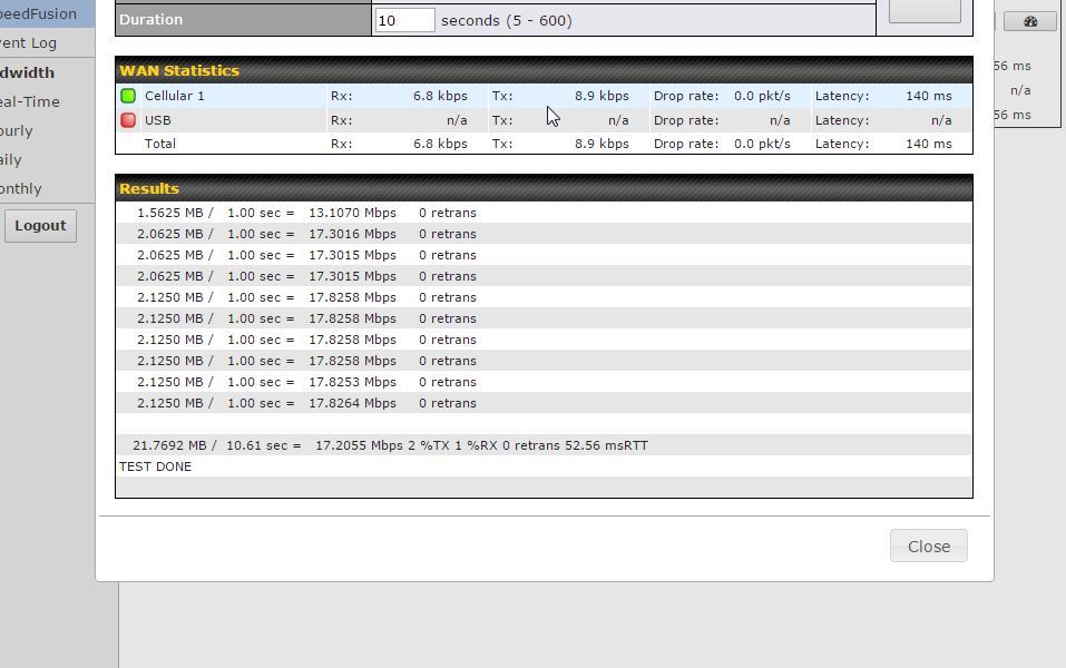

You really have a good cellular network coverage and >17Mbps upload speed on a single SIM is really nice. Would you please let us know what is the ISP of Cellular 1 and Cellular 2? We definitely want to take a deeper look about this issue, if possible, please create a support ticket here: http://cs.peplink.com/contact/support/ , send us your device’s Serial Number and turn on Remote Assistance (Peplink | Pepwave - Forum) then we will be able to get in and find out what’s happening.
In case if the two SIMs are using the same ISP, this will very probably having the same behavior as yours. This can be because there isn’t enough backhaul bandwidth at a cell tower, one SIM is already consuming all of the available bandwidth and therefore even two SIMs connected, they can only share half of the total bandwidth of a cell tower, you can find a more detailed explanation on page 9 and 10 of the “SpeedFusion: Best Practices” document which can be downloaded here: http://download.peplink.com/partner/SpeedFusion_Best_Practices.pdf

I was using 2 simcards from the same courier on the last screenshots.
This is one of my other routers a HD2. With 2 different carriers both on LTE the “3” connection usually gets about 16 mbit upload but now its about 10 and the other one is off the charts as you see. Bonding those 2 gives bad performance also.

May I know how you get 16Mbps upload bandwidth? By Speedtest.net?
Fyi, Speedtest.net will always choose the nearest server which is fast and having low latency as they have servers deployed all over the world. I suggest you test with the Speedtest.net server which closer to your remote peer.
