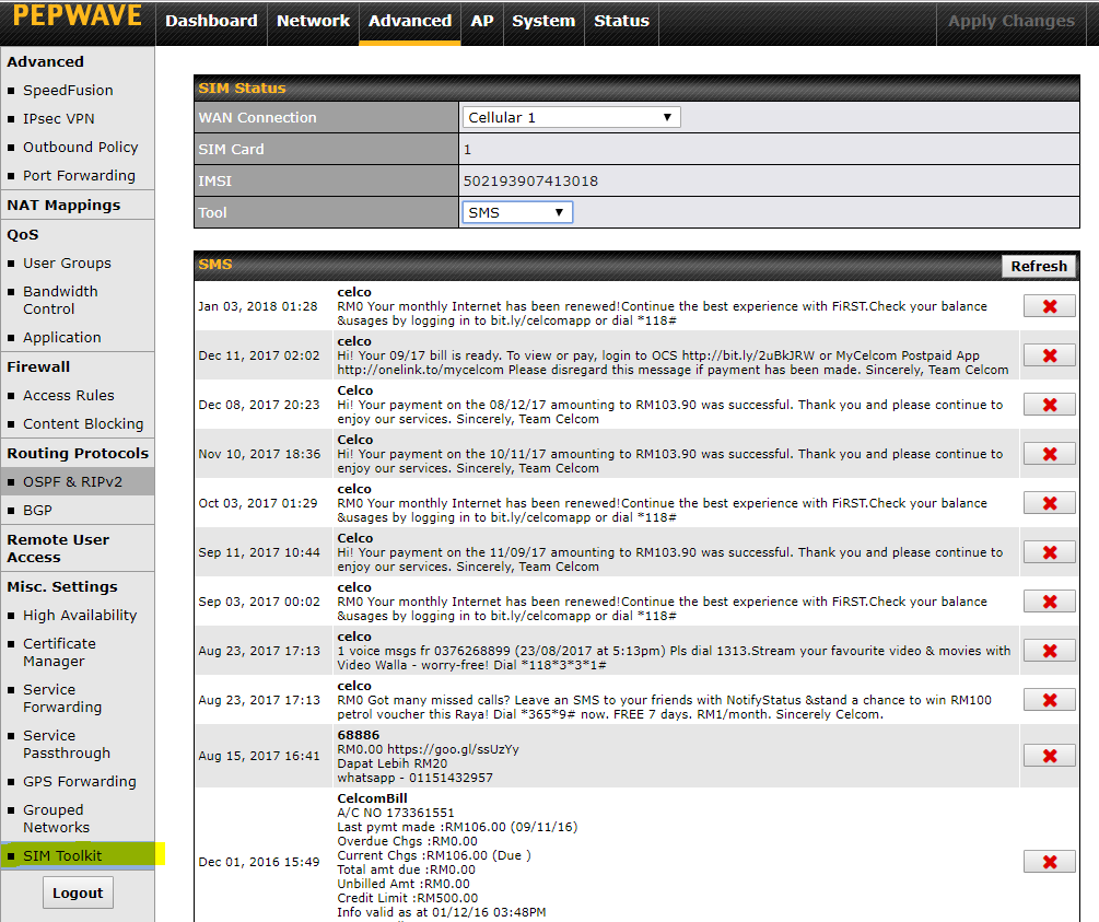

SIM Toolkit allow you to retrieve the SMS via WebAdmin access.
or you are looking at the device API level ?
What would cause the SIM Toolkit to say only “No SMS” under SMS or when you hit refresh button there? (when SIM in another device receives test text messages fine)
Does SMS reception through the SIM Toolkit have to be enabled somewhere in the GUI?
Both device having the same firmware version ?
Unfortunately, I only have one Peplink device that has cellular here, a BR1 mini, to test with. The SIM can receive text messages if I put it in another device (verizon brand MIFI hotspot). I don’t know much about SMS/text messages; I believe some plans can block text messages, but that is not the case here at least as the SIM can get text messages in another device, but none come through to the Peplink BR1 mini when viewing with the SIM tookit for some reason…
Is there any setting that has to be set to enable SMS through the SIM Toolkit on peplink devices?
@aquablue
Please open a support ticket for support team to check. This can be related to the SMS format store for the SIM card. Support team may need to check from the device in-order to confirm this.
