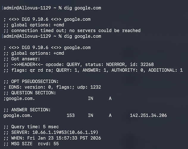

Here is the Terminal output:
; <<>> DiG 9.10.6 <<>> google.com
;; global options: +cmd
;; connection timed out; no servers could be reached
Clearly that’s different than expected. I checked a couple of settings for the laptop itself, and its browsers, but those don’t appear to be using DOH. Notably, the DNS tab of the System Settings/Network for the laptop’s active ethernet connection shows only one address, the LAN IP for my B One.

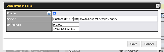

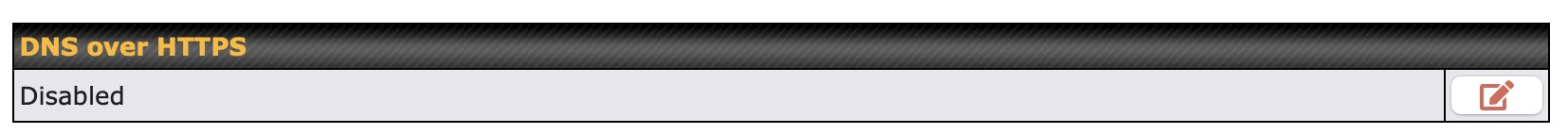

On the B One, I did have DNS over HTTPS enabled. Here is a screen shot of the settings:
When I disabled that, the troublesome laptop was immediately able to reach the internet, and of course passed the DIG test.
Next I changed the Time Server setting to NIST as recommended in the other post. Applied Changes and tested the laptop again… still good.
Then I re-enabled the DNS over HTTPS setting, which caused the laptop to fail once again. When I disabled it, the laptop worked.
Here is a Terminal screen shot, first showing the failed state, followed by the successful state:

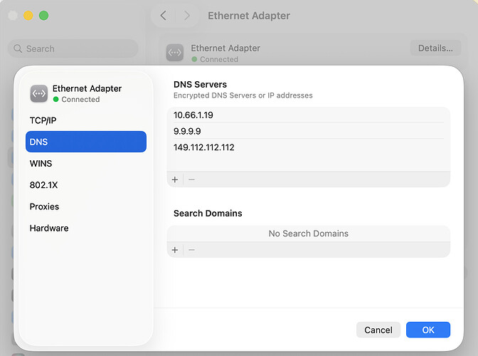

I looked at the System Settings/Network/Ethernet Adaptor/Details…/DNS tab and noted that it displayed one DNS Server address, which was my B One’s LAN IP. I wondered if adding the two IPs for Quad9 to the list would make a difference.
So, I made those additions, then went through the whole restart cycle. Lo and behold, the DIG test passed and I was able to reach the internet. Here’s a screenshot of the final setting on the Laptop.

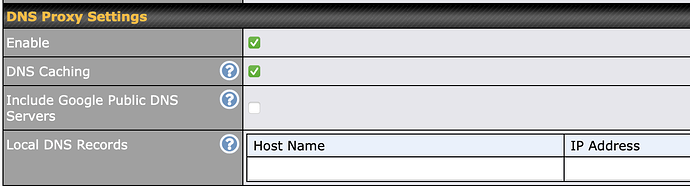

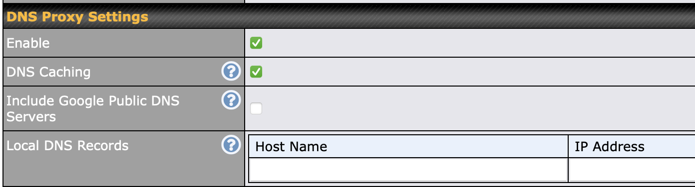

And in case it’s not clear, the DNS Proxy settings are on a different screen than DNS over HTTPS (on my Balance One, at least):
DNS Proxy Settings are on Network / LAN / Network Settings :

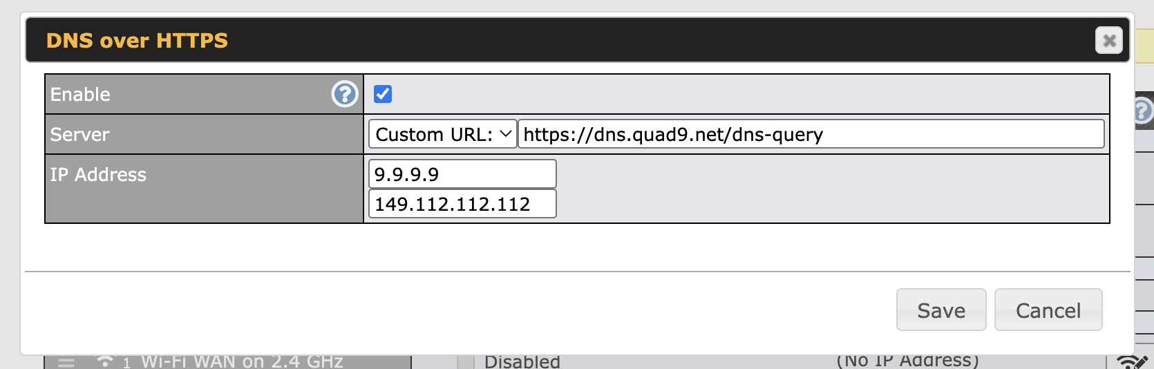

On a positive Barry’s tip on Quad9’s retirement of HTTP/1.1 accelerated my Peplink ticket to light speed. As soon as I pointed that out to the support agent, the issue was escalated and a few hours later I received an incremental firmware update which solved the issue, allowing me to use Quad9 for DNS-over-HTTPS without issue.
I should also note that Quad9 now works whether I use the Peplink preset, or do a custom entry:
https://dns.quad9.net/dns-query
9.9.9.9
149.112.112.112
Peplink subsequently confirmed that their preset uses that same flavor of Quad9’s service, but I prefer to see the info, rather than relying on the preset which does not display an actual URL in the UI.
