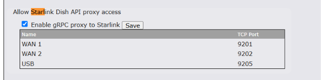

Hi All ,
Just to provide an update on the latest firmware: we have improved the WAN ID information displayed on the support.cgi page.
With this improvement, we can now identify the LAN proxy port corresponding to each WAN connected to a Starlink UT device.
For example, based on the screenshot:
  • WAN 1 → TCP port 9201
  • WAN 2 → TCP port 9202
  • USB → TCP port 9205
Assuming the Peplink LAN IP address is 192.168.50.1, you can access the Starlink UT connected to WAN 1 using:
192.168.50.1:9201
Similarly, the Starlink UT connected to WAN 2 can be accessed using:
192.168.50.1:9202
This allows us to identify and access the specific Starlink UT device based on the WAN interface to which it is connected.
