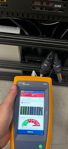

Hello @kevinp,
We use the same Fluke meter for testing all our custom cables; it does not do a certification (as required by the Australian/New Zealand standards as are necessary for Structured Cabling installations), though it sure does pick out the majority of issues and validates the performance. The unit exports a handy report when paired with the Fluke software, and we are optimistic that some AU/NZ certification may follow with future firmware updates.
This model can be plugged directly into Peplink routers & switches for testing the port’s functionality, such as PoE, Port Speed, DHCP and internet connection (if certain public IPs are visible through the firewall).
