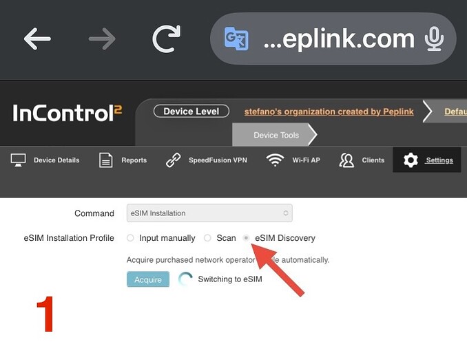

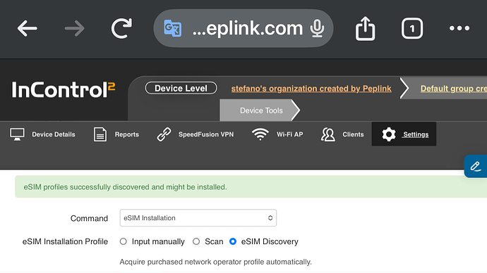

Here the steps I followed to activate the eSIM
You may need to repeat the second step several times.
During the process, you will need to connect your modem and phone to a secondary WAN line.
