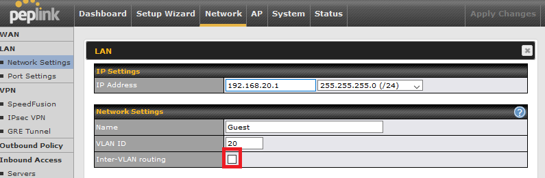

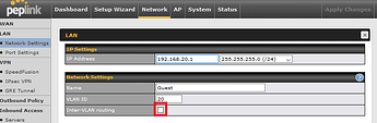

Create whatever VLAN’s you need for personal/guest/etc use, but specifically create an additional VLAN for your wife’s computer.
  1. When creating this VLAN, uncheck the “Inter-VLAN Routing” box.

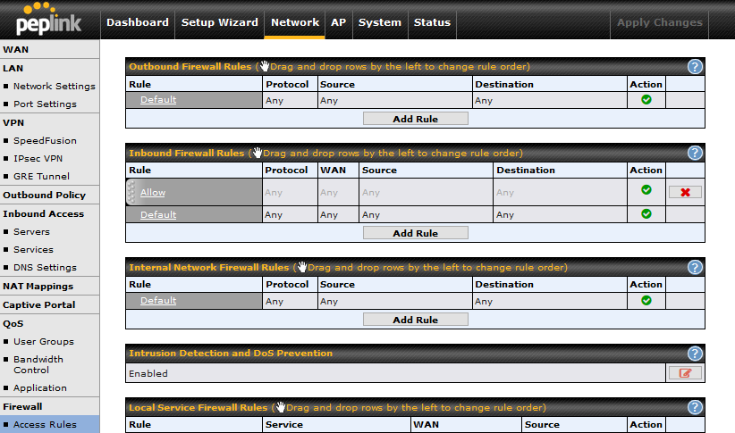

  2. Additionally, to further block this VLAN from accessing your private network, you can deny this VLAN from the “Internal Network Firewall Rules.”
To test this you should be able to ping any other device on any network and get the denial.

VLAN 10 - Private (inter-vlan checked)
VLAN 20 - Guest (inter-vlan unchecked)
VLAN 30 - Work (inter-vlan unchecked, internal firewall rules set to deny)
You are most likely wanting all wireless for each of these, so create a wifi network for each group, and then assign it specifically to that VLAN. Have your wife’s computer connect to VLAN30 or whatever you set and you should be good.

Simply created a VLAN and turn of the intervlan routing. Then create a new SSID and associate it only with that VLAN. You now have an isolated Wi-Fi network.
