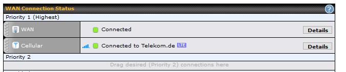

All WAN ports within the same priority are able to use loadbalancing algorithms.
Just drag wan 1 and cellular to priority 1

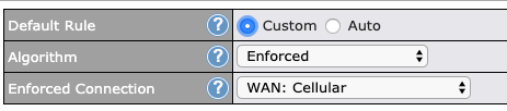

Can cellular WAN be used in outbound policy if its a “standby” WAN?
Normally no. Using most policy algorithms no. But what if we define like this?
Here is an exception. With enforced policy cellular “Standby” can be used (tested FW 8.0.2 b1480).
But with “Cold Standby” there is a deadlock!
How do I get it out of “standby” ? Can I just simply drag it up with “priority 1” and it be used along with the hardline? Or do I checkmark “Independent from Backup WANs” ?
Both ways are acceptable. “Independent from Backup WANs” is the same as Priority 1 technically. The only difference that when independent WAN, then you cannot drag it anymore to a lower priority.
