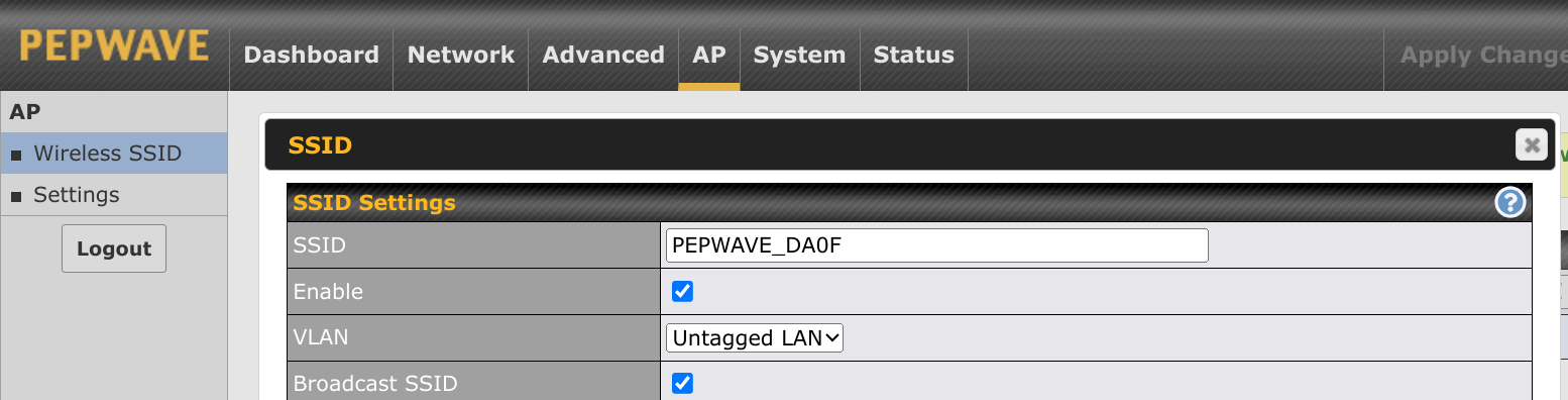

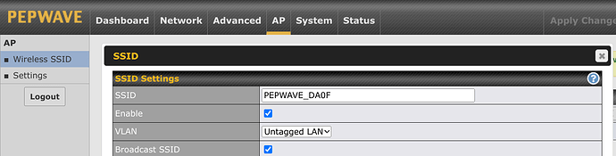

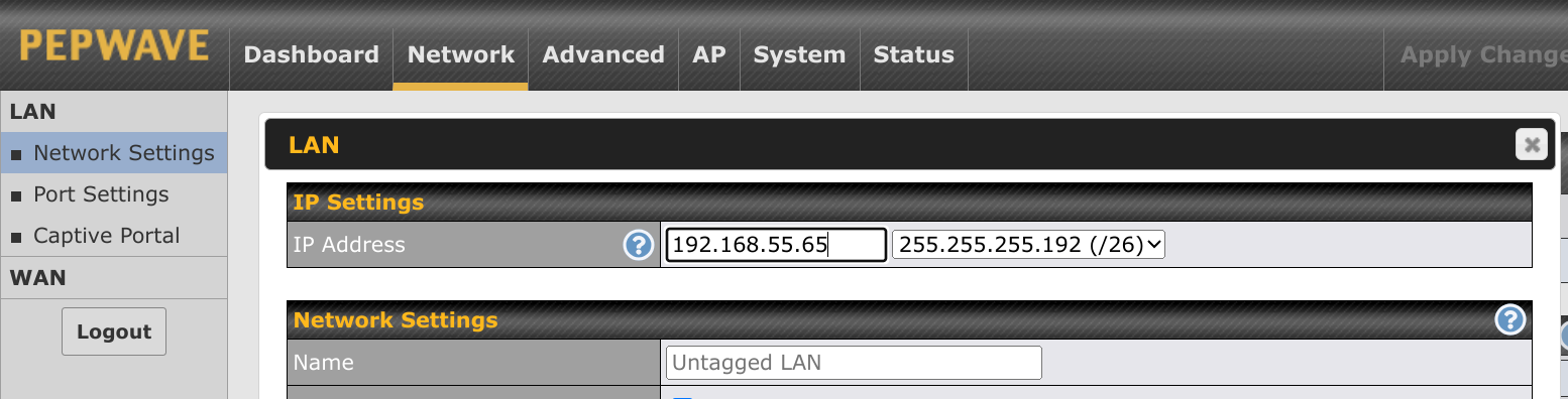

Yes… You need to change the ip address of device to be one ip address not in use of your network… look the ip address at:
change the ssid to name and password.

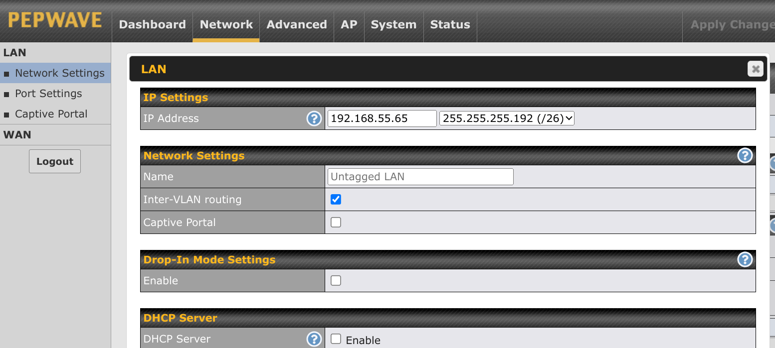

and… because you already have a router in your network… you need to connect the device LAN, not WAN of the peplink device in your network… and please… keep the dhcp of peplink device OFF.

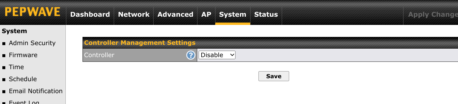

Disable incontrol of the device…
Don’t forget… save and apply each change that you are doing.
This way… the peplink will be just an AP (broadcasting the WiFi signal).
Comment… the ip address in the screens… are just a sample.
