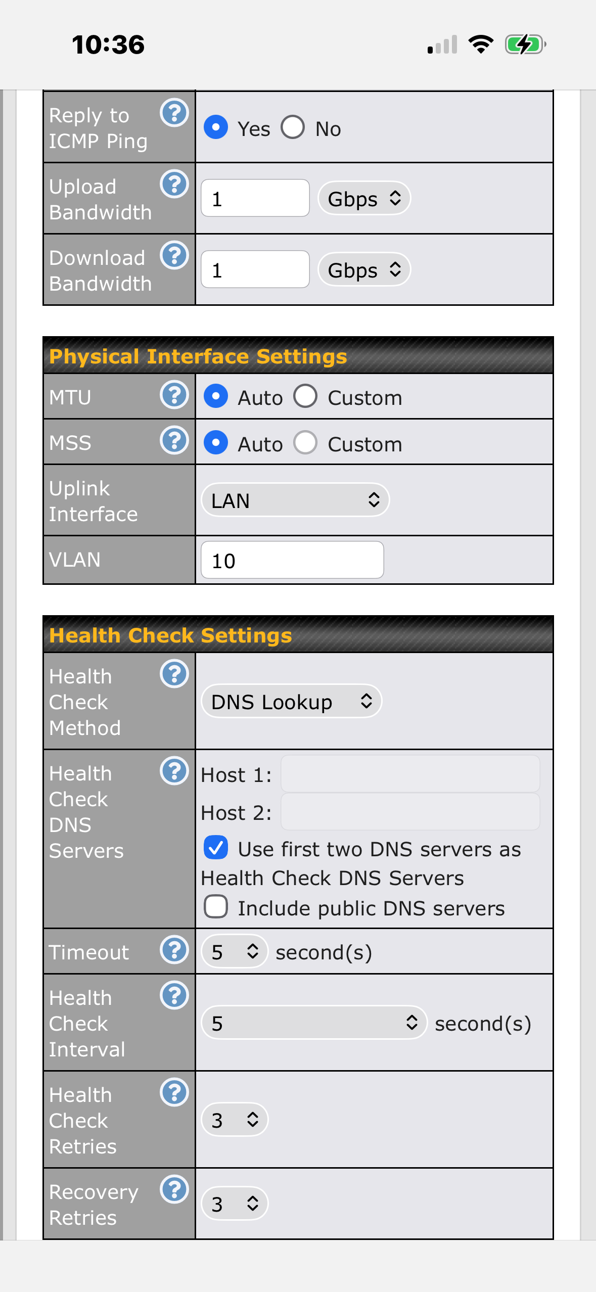

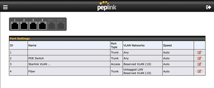

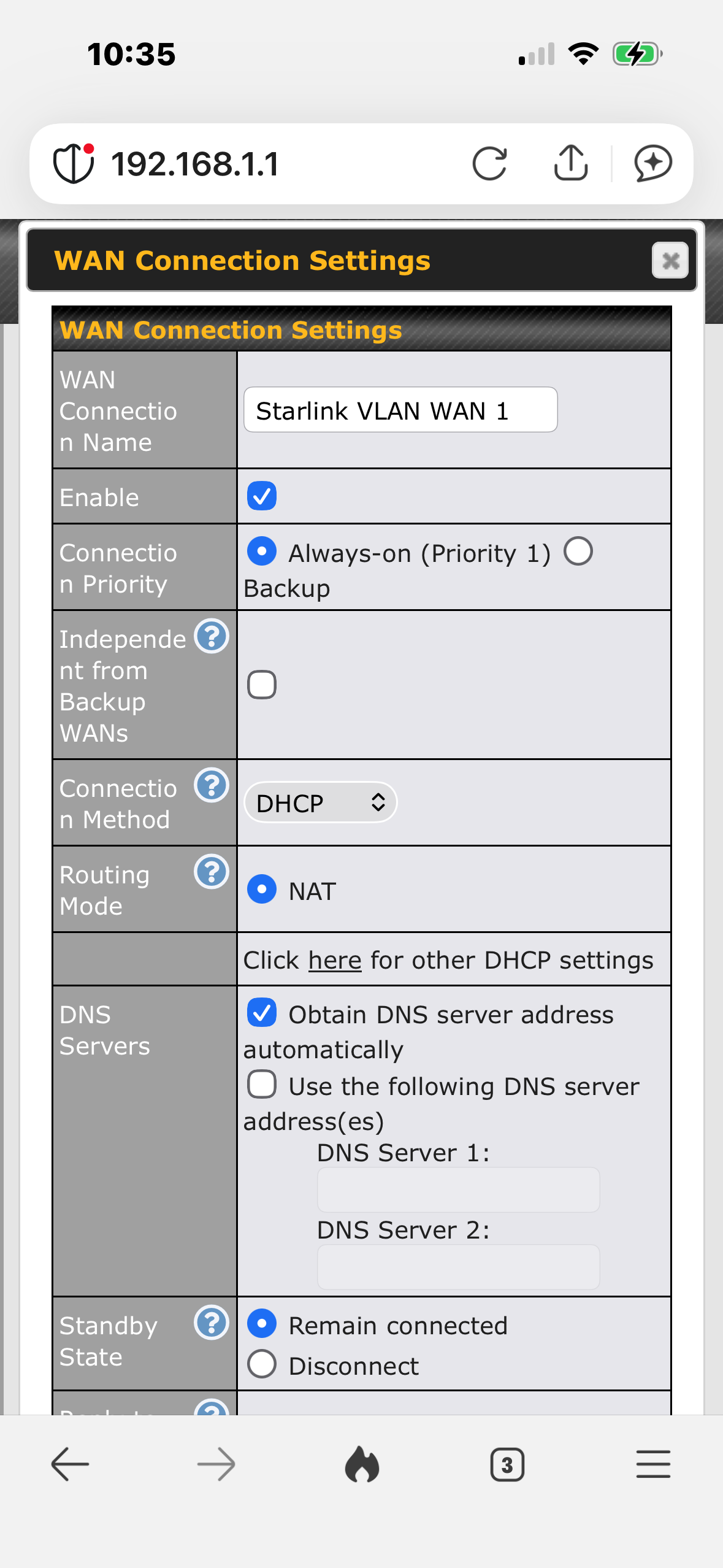

I’m not using Synergy. At the remote end I built a VLAN called 10 and assigned it to port 3. I plugged my WAN into port 3. Port 4 is my fiber down to the house. I added. VLAN 10 to this port for routing to the house.
At the House end I specified VLAN 10 on the WAN connection and it came up working.
Remote Network Port settings:
House end Physical Interface settings of WAN:
Let me know if these pics don’t come through. I’ve never posted from my phone with pics before.
Thanks! The pics did come through and I’ll see if I can make this work.
