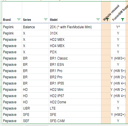

Do we have any more compatible SIM injector devices, since this was last updated?
Thanks
Here is the recent model list:
