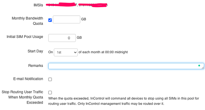

I’m trying to figure monthly usage carrier wise,
I can use bandwidth endpoint and mention wlanid=2 , problem is we use multiple sims and switch between them a couple of times, then the output from this endpoint is the sum of both carriers which is not I’m looking for.
sim_usages endpoints look useful for me here, but the problem is, upload/download figures don’t match within control UI. UI uses bandwidth API. why the output from these two APIs are different.
The InControl web site just uses the same set of API to generate the SIM usage reports. So they must match. The differences may be because your input parameters are different or wrong.
I have a tip for you. But it will need some web development skills. Before loading up the SIM Card Reports on InControl, press F12 to enable the developer tool on your Chrome browser. After a specific SIM card report is loaded, in the Developer Tool, select the Network tab, then the “XHR” tab in the filter bar, look for the API call that is for retrieving the requested data, and then click into it. On the right pane, select the “Headers” tab, check the “Query String Parameters” field. It shows what parameters the InControl web site has passed to the API endpoint to request the piece of data. Compare the input parameters with your API client’s.
