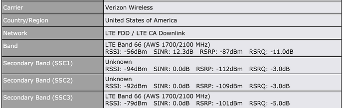

I’m seeing funky info for an LTE-A connection for the secondary bands. Not on all carriers - it seems to only show on Verizon (see below) where the secondary bands don’t show a band identifier, but show very odd signal levels. I know I am getting an -A connection because of my overall throughput (70Mbps plus versus standard LTE) and I have a MAX Transit installed on the same boat that shows the correct info.

There are few bugs reported for the WebUI display in firmware 8.0.2 for the Cellular connection and tentatively should be fix in firmware 8.1.0 (beta 4 now). Do you think you can open a ticket for support team to further confirm ?
I’m happy to try 8.1.0 b4 if that is the solution instead of opening a support ticket to save time/resources on your end, at least for the weird display.

I upgraded to 8.1.0b4 and can see more details at certain times, but still see some blank band info.
On a positive note, I see the controls in Remote SIM Management to set various SIMs for roaming/no roaming which was my biggest concern with 8.0.x
I am also seeing better throughput performance in general on 8.1.0b4 with what looks like better band management / three secondary bands instead of just two.
