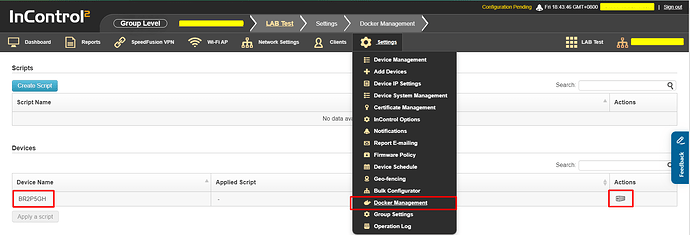

I’ve upgraded to Beta 3… I’m not seeing Docker mgt in IC2. From the release notes:
31957 [Beta 1] [Docker] Added Docker management support via InControl.
Can someone point me to it? I’m looking for it…

It is under the Group > Settings, I have my test device with a Docker app installed.
When I click on the icon under the Action column, it displays the Docker container of the router.
I tried that. No docker mgt in my IC2 Device group.
