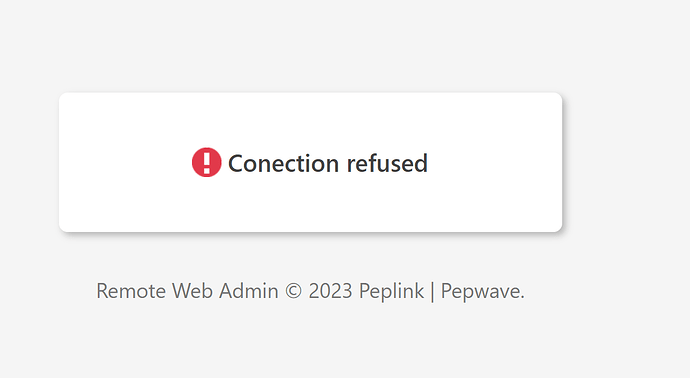

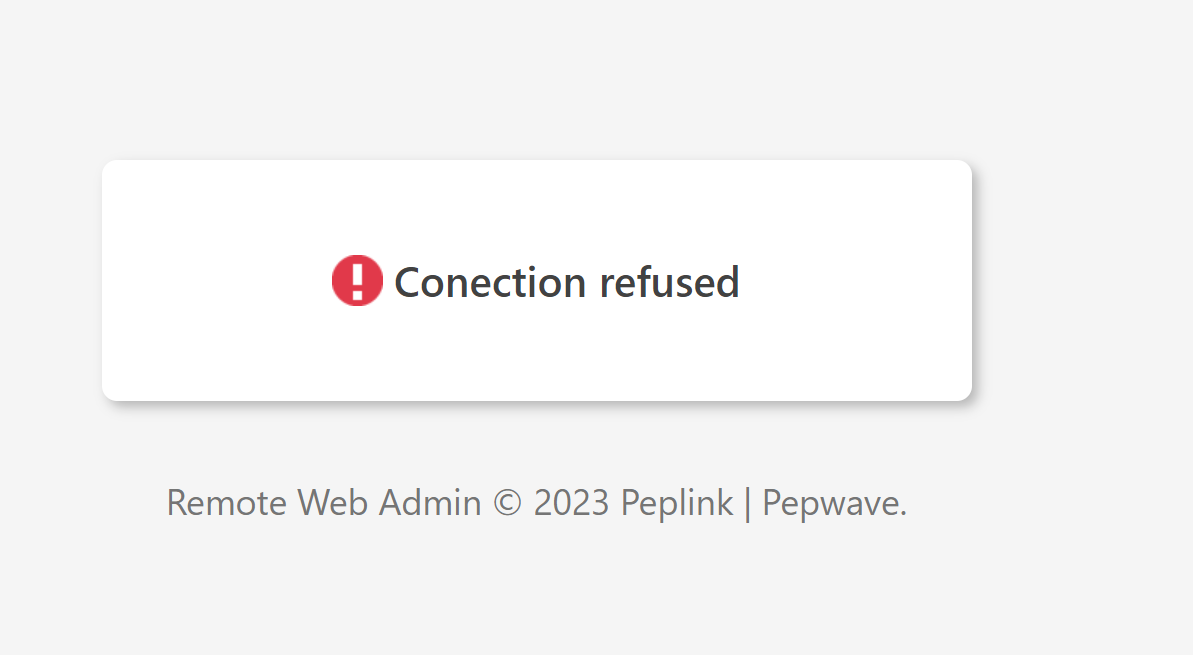

Grammar Police Notification
Spelling “Conection” => “CoNnection”
