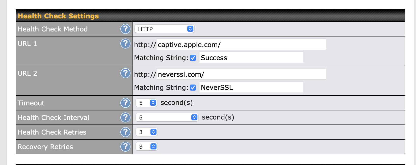

I have noticed that the Cellular health check on the b20X is often alerting on Beta 2. The interface does not reset, but the health check bounces.
I switched back to Beta 1 and the issue subsided. It was stable on 8.1.3 as well.

For the health check issue , Can you please open a ticket for support team to check ?
Thanks, I had to revert, I was causing too much trouble for those that depend on the device. I’ll hang tight and wait a rev or 2, hopefully they can confirm this behavior, and it sounds like others have had openvpn reconnection and outbound rule issues
