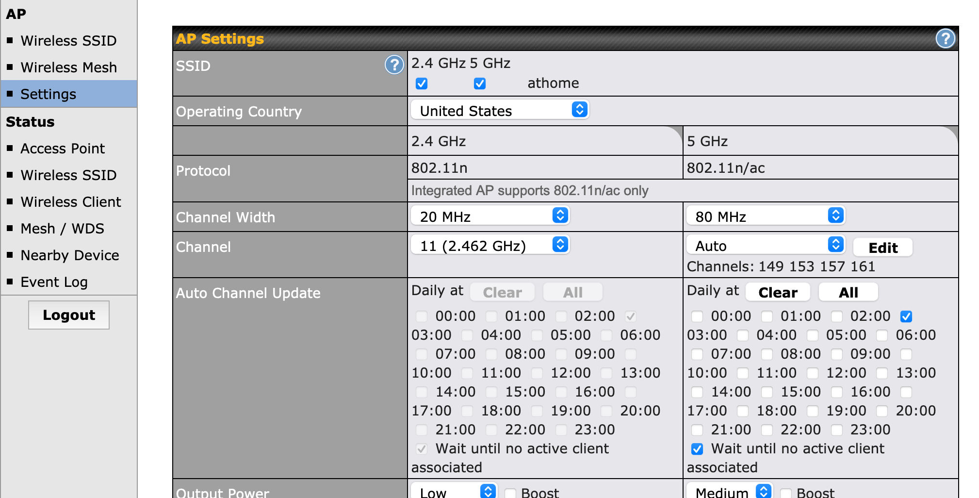

Do you have both 2.4 and 5GHz checked as below:
I’ve tried just 2.4Ghz with 5.0Ghz off… also tried both enabled. Didn’t make a difference. I also played with all the various Width and Channel settings - no luck.
I even enabled the advanced settings and toyed there a bit. You click on the ? button in the upper right hand corner to see them FYI.
Are you sure you’re making the changes correctly? First you save and then you apply (just trying to be thorough). Perhaps you could say which device you’re using and post a refreshed ssid settings screenshot.
