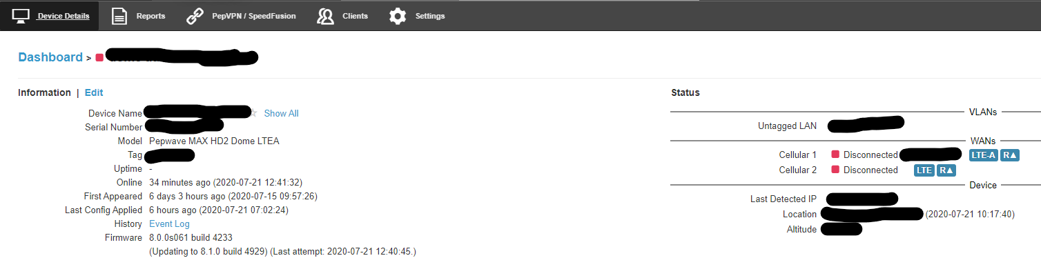

We have had a Pepwave MAX HD2 Dome go offline during an upgrade to FW 8.1.0 build 4929 from FW 8.0.0s061 build 4233. Upgrade was initiated through InControl2. Is there any prerequisite that would cause this?

Hello Peplink Team,
The router has come good by itself overnight, it took about seven (7) hours for the Modems SIMs to establish a connection, these have SIMs that are roaming from Europe.
Diagnostic logs are available for analysis, please PM us for them.
