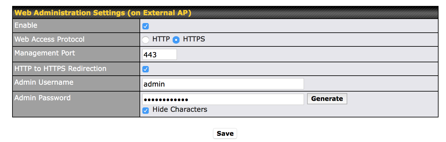

We have noticed that in 7.1.0, we can no longer view the AP controller password for external APs under “Web Administration Settings (on External AP)”
7.1.0
7.0.2
In the past there was a little “Hide Characters” button below the password field as in the image above.
Have seen this on a Balance ONE and Transit DUO
Thank You
@SamuelNorris, Thanks for reporting this. We have filed this bug and we will fix this in the coming firmware release.
Thanks.
