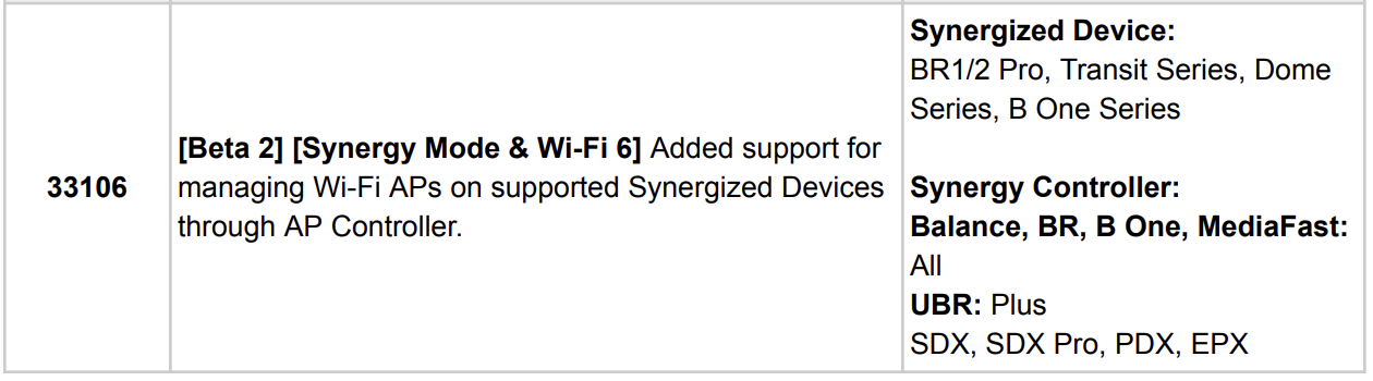

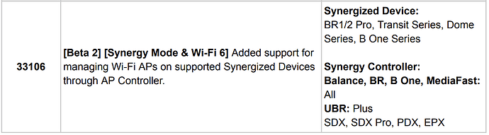

Give it a try with 8.6.0 Beta 2 to see whether that works for you. :wink:
The way this reads it said wifi AP’s , I wasn’t thinking that it would allow the synergy of both the wans and the wifi radio with in the same router (Synergized device), is this true?
Synergy Controller will manage the WAN of the synergized device on WAN setting and AP of the synergized device on AP Controller like a managed AP.
