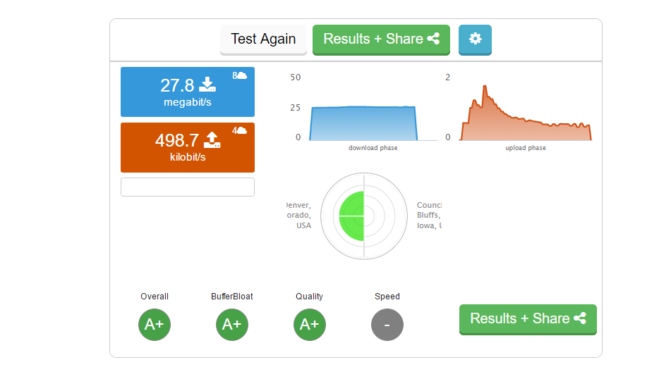

I got much better results on bufferbloat by using QoS settings at 70% for managers
Strangely with exactly the same settings and my other devices not active I can get failing bufferbloat sometimes (not usual). I don’t know what would cause such variability.
Doc, can you say how you set up your QoS settings?
Really only internet use is by managers but I thought, perhaps, limiting
bandwidth here might increase queue use
The order on these images got messed up in the email response but I’m sure that can be figured out if noted here.
Made all assigned IPs managers
Finally all WAN download speeds were reduced to 80% of max and all WAN
upload speeds were reduced to 70%
I admit this is a pretty draconian reduction in bandwidth but staring at
bandwidth use during gaming showed I seldom really got above 8mbps so the
lag, pauses and etc that show up in game
seem to have been BufferBloat. Now I can play the game with much less slow
down during intense activity…when it really matters. I generally get
speedtests now that look like this one I just took:
