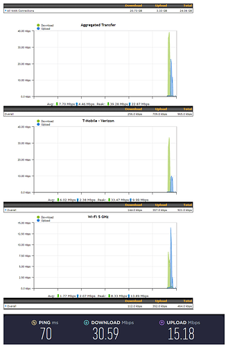

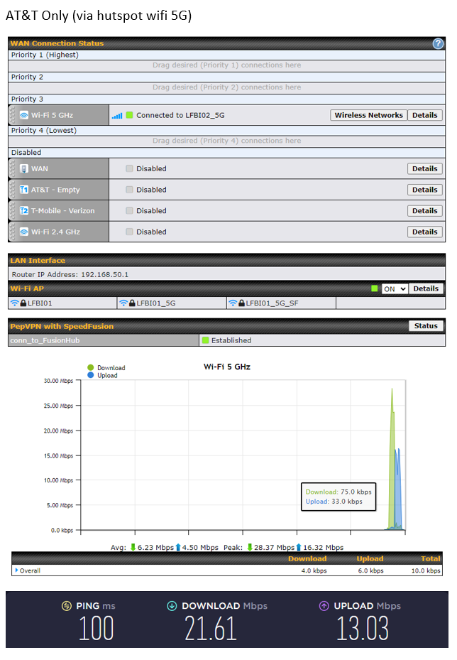

I’m not able to get bonded connections to show an improvement in download speed. My details are below.
There must be a way to get bonding to actually improve speed. My guess is that my settings are resulting in bonding, but they appear to be load balancing instead of aggregating the connections. Any ideas?
Have you read through this…
Thanks for the link. I read through the post. Hard to know if the issues in that thread are the same as the issues I’m experiencing. However, it did give me some things to try.
Please keep us posted!
Absolutely will. I’m traveling cross country so it may take a few days to get some test completed, but I will report back.
