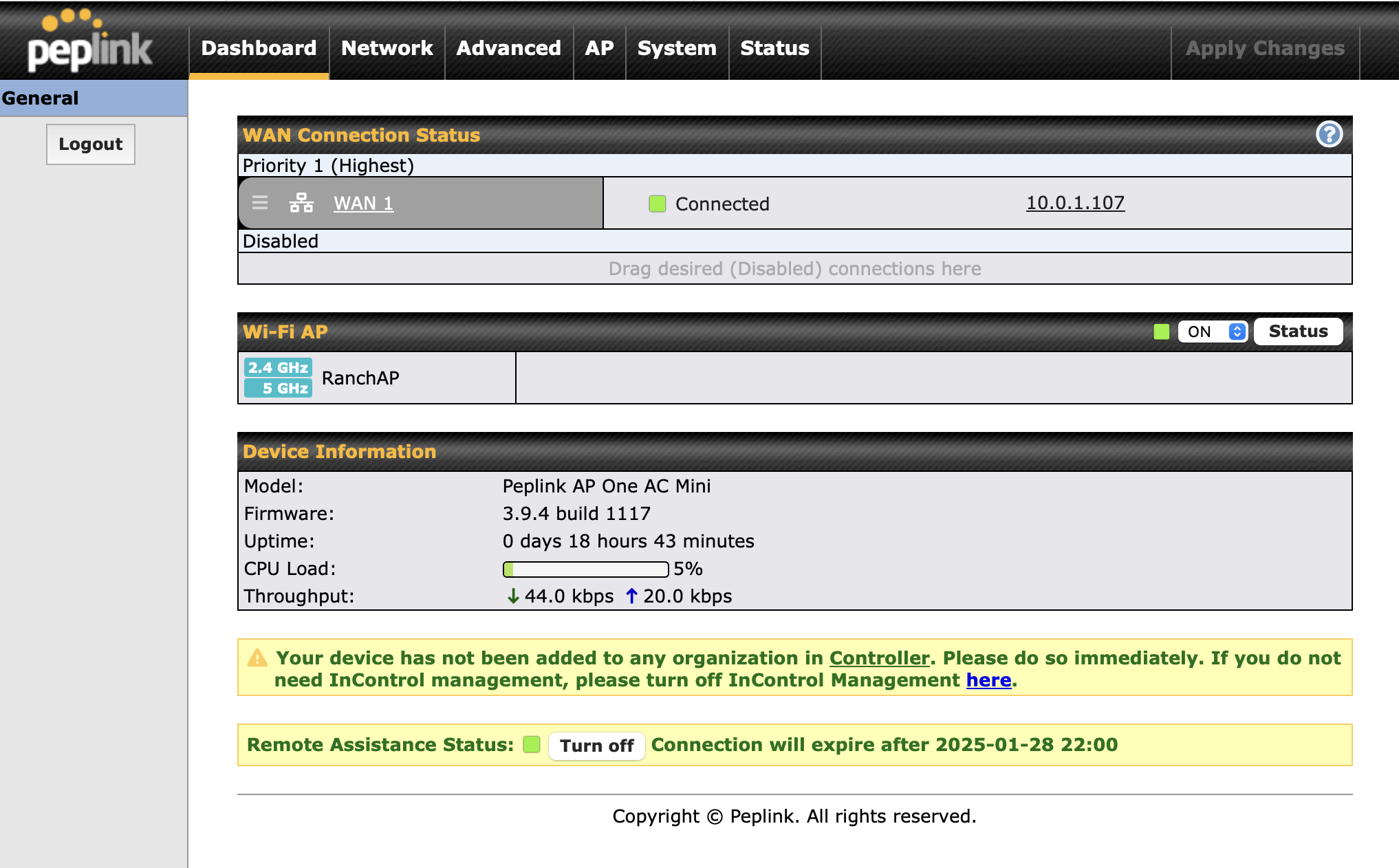

Well this has turned out to be a disaster, I purchased the One X mini as a test and have been unable to add it to the Balance Controller, I did open a ticket and in all honesty it has to be the worst support I have received in over 20 years in the technology industry.
Having invested in Peplink and mostly happy with the performance, this was the first ticket I have needed to open and despite the investment I can NOT have something that when there is an issue you guys hide under a rock.
Looks like Peplink is no longer the solution for me.

Thanks for the suggestion, yes, I have tried this with no success,
interestingly I get this error when that is set:
The AP seems to ignore the DHCP option and just gets an IP and acts as a stand alone AP:
Any thoughts much appreciated
Hi, @jeffrr
Please… Are you getting a support from Peplink team?
Why your RA (Remote Assistance) is enable?
Also…
Please… register the serial number of your device at IC2 (Incontrol)… doing this… the message about "not been added to any organization " will stop.
