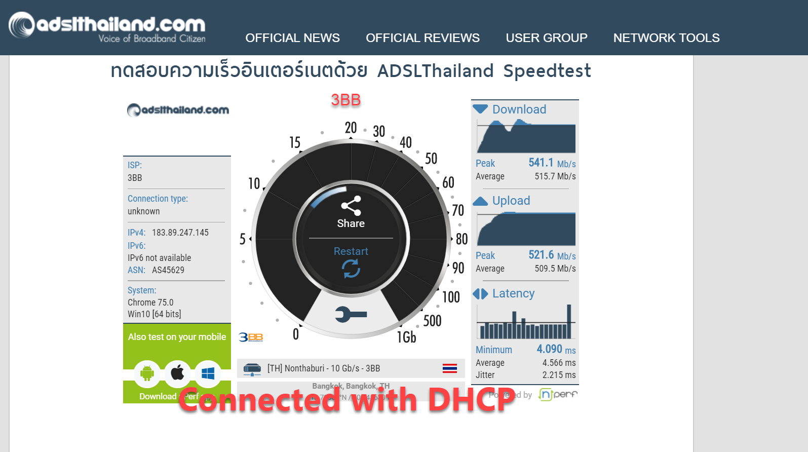

Hi Same like in case.The customer used Peplink Balance One & Balance One Core If connected with Mode DHCP or static IP throughtput based on ISP but Connected with mode PPoE it’s many lose of speed bandwidth see details as attached file
WAN 1 : 200/100Mbps
WAN 2 : 200/100Mbps
WAN 3 : 200/200Mbps
CPU will hit 100% arround 250Mbps if WAN are using PPPoE
but it work just fine if I switch all connection to DHCP/Static

1 PPoE Connection + 2 DHCP ( Weighted Balance 6:8:8) Max around 500Mbps of total BW
1 PPoE Connection + 1 DHCP ( Weighted Balance 5:5)
2 DHCP - (MAX out BW)
PS. very similar result with 8.0.0 and 8.0.1-build2684
