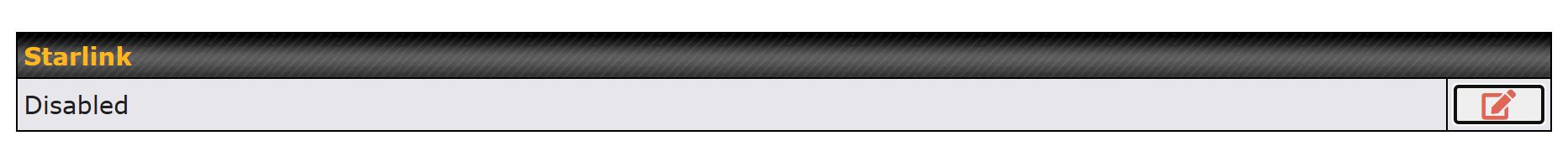

You can also enable Starlink for that WAN port on the Network tab, WAN, Starlink at the bottom
Honestly, no idea if this will help at all but it does let the router get additional errors and log them.
