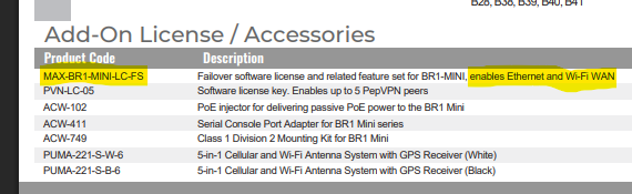

Do you have the Feature Pack for MAX BR1 Mini (MAX-BR1-MINI-LC-FP)?
It is not a primecare device. I don’t know about the feature pack. I bought the device from a distributor and followed the recommended firmware updates. What do I need to do next?

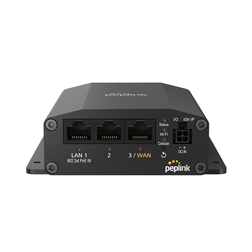

What is Hw3 stand for?
Hi…
HW1 have only two rj45 ports (interface)
HW3 have three rj45 ports (interface)
Correct three rj45 ports
From the doc you provided looks like I need a license? I was using this previously without. Do they provide the license initially and require a subscription after a certain time? If that is the case, where do I access the license? Thank you!

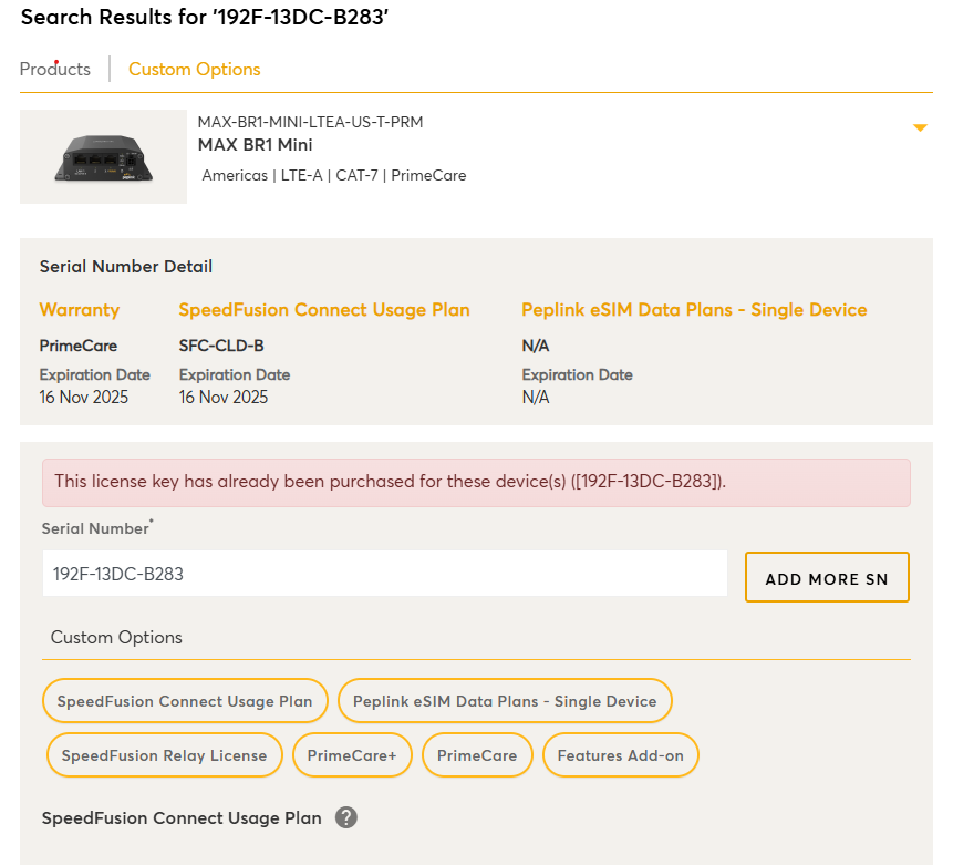

Do you have this device at Incontrol2
https://incontrol2.peplink.com
OR
you can go to
https://estore.pepwave.com
Type the serial number of your device, at search.
XXXX-XXXX-XXXX
And you can check about the primecare of your device.

From Peplink Accessories I found that my serial number had already purchased the MAX-BR1-MINI-LC-FP. Ust have been when I purchased the unit. I had performed a factory reset (paper clip hole) recently when I had issues with both cellular and wifi. That is when I updated the firmware.
By doing these, did I lose the MAX-BR1-MINI-LC-FP? Can I check my unit somehow to see if that accessory is still attached? I am also getting “Failed Lease for Wifi Wan” connection in Event log? Is that pointing to not having the MAX-BR1-MINI-LC-FP? Can I get that license again if it’s already associated with my SN? Thanks
Appears I do have PrimeCare until Nov 16. I checked the license for MAX-BR1-MINI-LC-FP and put it in the cart and here is the message below: See my next thread on how I can verify it is loaded and if not, how I can reload.

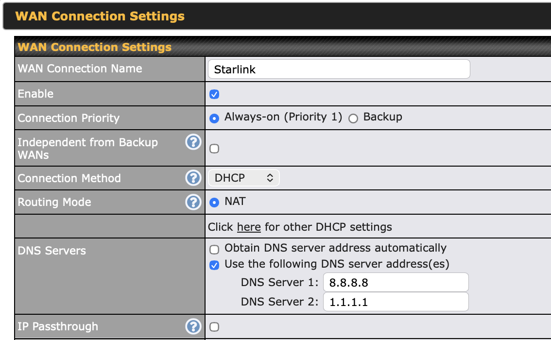

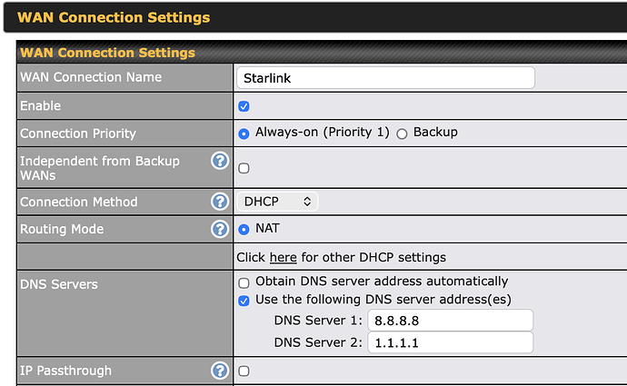

I was having a similar issue but my BR1 Pro 5g wouldn’t assign IP Addresses to my clients. Through a lot of frustration and trial and error, I found that I had inadvertently selected the IP Passthrough option on my Starlink connection. Removing this resolved all of my issues. Maybe check this on your Wifi WAN connection.
