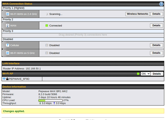

Once it boot cycled and started back up again I logged in and started setting things up. First I tried to apply a wi-fi as wan connection for my 2g connection and tried to connect to my home router.
Once I applied the settings saved and tried to connect I am hit with a connection in the wi-fi as wan but not really seeming to try to connect. I went to the event logs and seen nothing out of the norm there but it didn’t really have any relevant information for me there.

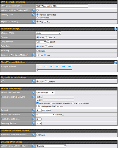

Another odd thing to me is that when I create a hot spot from my phone it seems to connect just fine but for some reason doesn’t want to connect to my home router which is a netgear R7960P.
My wifi as wan settings
