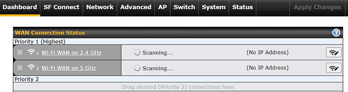

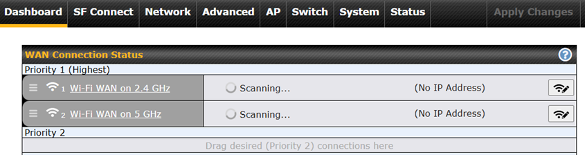

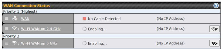

I don’t know why it take so long “Enabling…” then “Scanning…” then “Connecting…”

I measured each process from power on to connecting to another MAX BR1
  • Login web start: 50 sec
  • Enabling wifi: 1 min 40 sec (!)
  • Connecting to AP: 3 sec

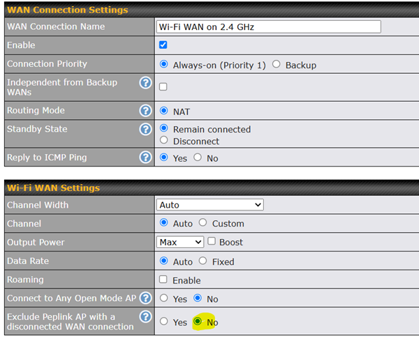

  • I disabled all cellular and only enabled 2.4GHz WiFi between Router #1 and #2 all running 8.5.2 build 5862

This is absurd amount of time to just booting and connection.
What is it doing while enabling the wifi?

What is your application? I assume this is not a fixed install? Are the routers powered on and off a lot?
How many wifi WAN SSID profiles do you have configured? Is one set as the Preferred BSSID?
I would suggest you enable roaming first then depending on your application consider, turning on intensive scan and drop the Scan interval.

There are only 2 routers and saved as preferred SSID and not allowed to other profiles.
Don’t know if enabling the roaming option would affect time to “Enabling wifi”
